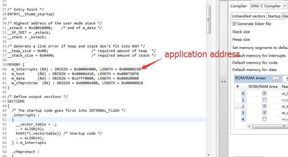

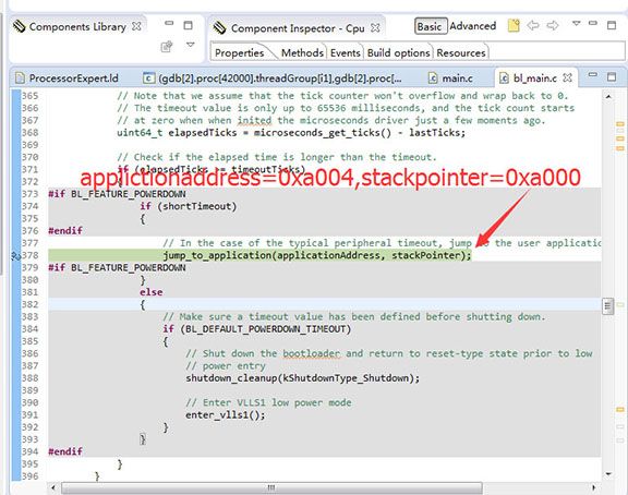

donot from Kinetis Bootloader V2.0 jump to my application with MK22FN512
1,573 Views
andypeng

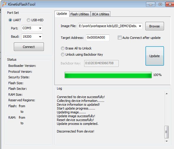

I am using freedom_bootloader of Kinetis Bootloader V2.0, application update MK22FN512, using serial connection communication, KinetisFlashTool has been written to the end. But then did not jump into my application.
Thanks in advance, andypeng

Hi Andy Peng,
Please provide more details about your issues, for example, the Bootloader build(Debug or Release), compiler, and it would be great if you can provide the application binary for further investigation.
Fan
