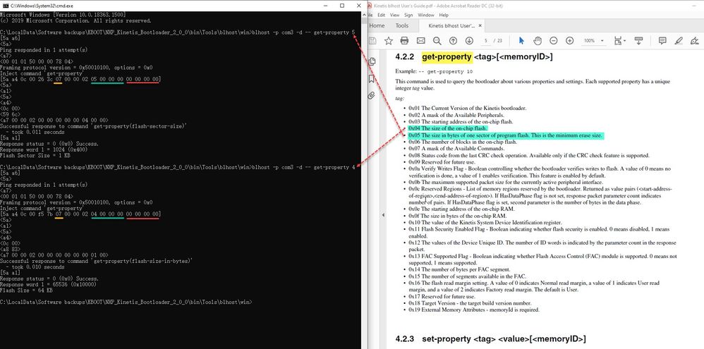

1. Please try the get property command on KL17Z by using  blhost, to check the flash sector size and flash size. Refer to the blhost User's Guide, chaperter 4.2.2.
Here is the log for KL27Z:
2.For internal flash memory, memory ID should be 0, not 0x01.
3. blhost download:  https://www.nxp.com/mcuboot

Hi Robin, thanks, i try but it doesn´t work,
i test it at different baud rates (115200,19200,9600), also put a pull up resistor on LPUART RX, but i only get PING response.
LOG:
PS D:\MCUXpressoIDE_10.2.0_759\workspace\blhost_2.6.6\bin\win> .\blhost.exe -p com2,115200 -d -- get-property 5
[5a a6]
<5a>
Ping responded in 1 attempt(s)
<a7>
<00 01 01 50 00 00 78 04>
Framing protocol version = 0x50010100, options = 0x0
Inject command 'get-property'
[5a a4 0c 00 26 3c 07 00 00 02 05 00 00 00 00 00 00 00]
Error: read_start_byte() timeout after 5.110 seconds
sendCommandGetResponse.writePacket error 5.
processResponse: null packet
- took 5.113 seconds
Response status = 10004 (0x2714) No response packet from target device.
