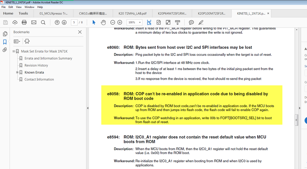

kerryzhou
Hello Daniel Truong,
     These chip: KL03, KL13Z128/256, KL43, KL27Z128/256 will disable the watchdog after boot from ROM.
    Actually, our errata already add the according description:
http://www.nxp.com/docs/en/errata/KINETIS_L_1N71K.pdf
Wish it helps you!
Kerry

danieltruong
Kerry,
Thanks for the errata information. It is indeed the root cause of the problem. The mask set number of the chip is exactly 1N71K.
For the workaround solution, it is recommended to use the option to boot from Flash instead of ROM. I changed back the FTFA_FOPT register to 0x3D to make it boot from Flash. And the COP can be enabled and used throughout my program.
However, if I do this, I have to give up the capability to upgrade firmware thru the ROM bootloader. Not sure how to achieve this with a "flashloader".

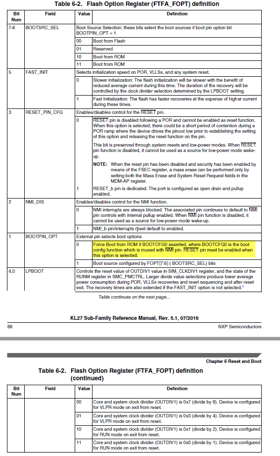

  You won't give up the capability to upgrade firmware thru the ROM bootloader. Just configure FOPT[NMI_DIS]=1 and FOPT[BOOTPIN_OPT]=0.
 You can find the detail description from the reference manual:
When you want to use the ROM bootloader, just press the NMI pin, hold on it, press the reset pin, release reset pin and then release NMI pin, the MCU will enter the ROM bootloader.

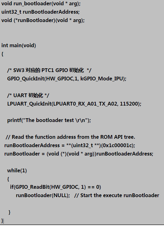

kerryzhou
Question: how I can implement the FW updading via a Flash bootloader.
Answer:
  1. Erase all the flash at first, or erase the FOPT to boot from ROM, then reset, the code will boot from ROM again.
  2. In the application code, give some external condition, then call the ROM.
Kerry

danieltruong
Hi Kerry,
when I jump back to Boot ROM from the Flash, it won't work the same as booting straight from ROM, ie. It doesn't talk to the host SW to set up the firmware upgrade.
Since I don't have access to the code in ROM, I have no idea what happened.
I'm back to square one. Either Boot from ROM and be able to have firmware upgrade from host, but must give up WDog. Or boot from flash and have WDog, but must give up FW upgrade capability. Or must implement a switch at NMI pin to force FW upgrade mode when the switch is pressed at power on.
