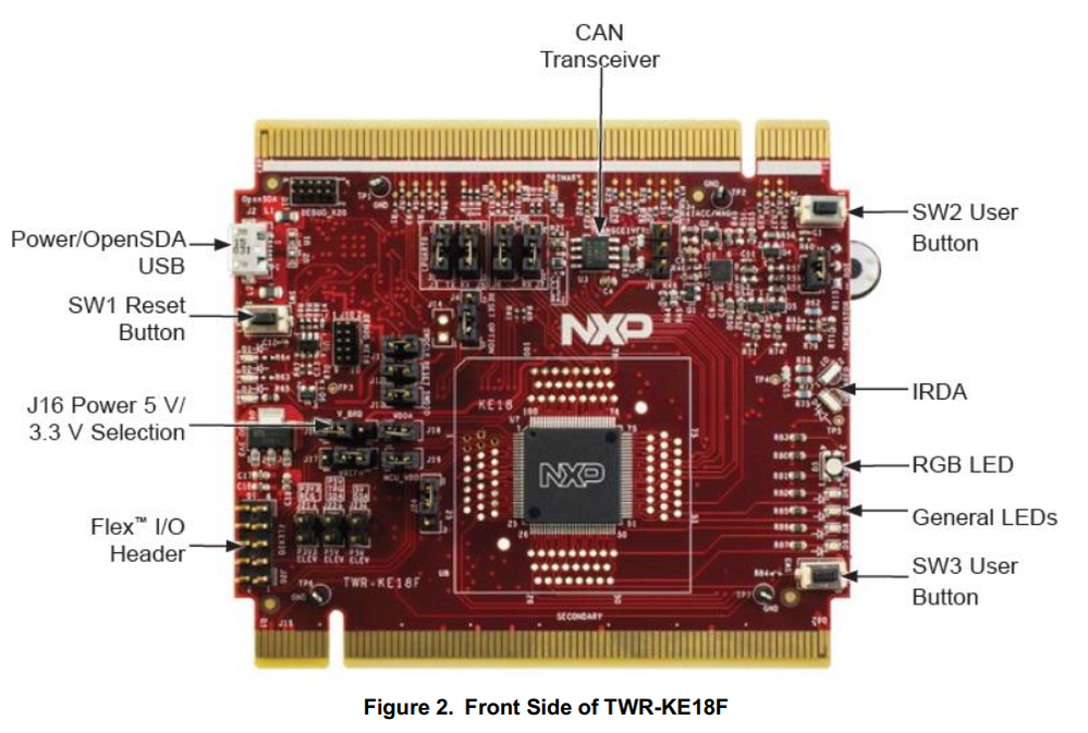

When i connect TWR-KE18F to my PC it shows portal device instead of COM PORT. I unable to change bootloader due to that problem.

I already  connect my TWR_KE18F board to my pc. I pressed reset butten and then connect my board to pc via usb. But it shows portal device instead of COM PORT in device manager. due to that i unable to change bootloader and unable to load any application program to TWR-KE18F.

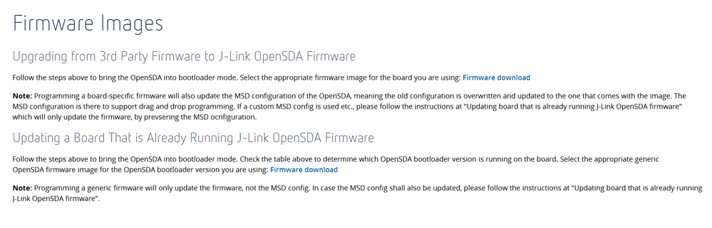

Please refer TWR-KE18F board user guide to set jumper to default setting.
Then, customer could check here to download Segger J-Link firmware for TWR-KE18F board.
Please check here about how to update the TWR-KE18F board firmware.

1. Press SW2 (switch for NMI ) and RESET switch together and plug-in USB cable to enter in BOOT LOADER mode.
2. Drag and Drop .bin file of new supported firmware.
3. Remove USB cable and plug-in again.
4. Now the board will work.

Please don't press Reset button & plug in USB cable,  when you just want to debug with on board OpenSDA.
When you want to update the OpenSDA firmware, you need to press Reset button and plug in USB cable.
I don't receive another issue reported about TWR-KE18F board OpenSDA debugger.
Please check here to download suitable TWR-KE18F OpenSDA firmware.

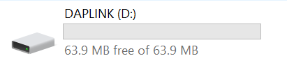

When you press RESET(SW1) button and connect USB cable to PC, you will find the TWR-KE18F enumerated as a USB disc:

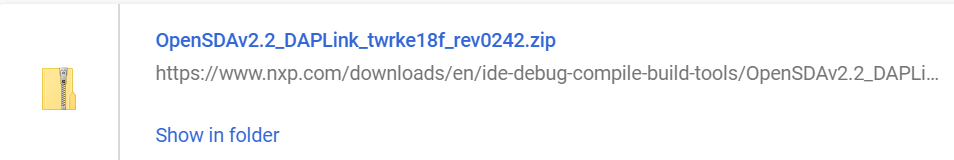

Then you can visit here to download DAPLink rev0242 firmware:
You can copy and paste [k20dx_twrke18f_if_crc.bin] to DAPLINKBOOT(D:) disk.
After above steps done, you can re-plug USB cable to PC without press RESET button, you can find DAPLINK(D:):
From Windows Device Manager panel, you could find there shows DAPLINK:
Then you can use DAPLINK to debug the code with MCUXpresso IDE software.

qzy_perfect
Hi, Ma
   I try it, and then comes the good news that now my board can work again.
   Thanks for your help, and thanks for everyone who have given me a big hand.
