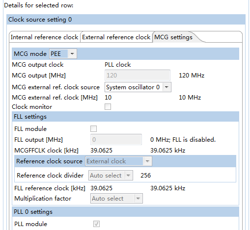

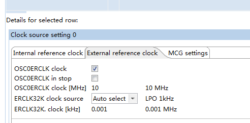

APP uses the clock mode: PEE, the external crystal is 10MHz

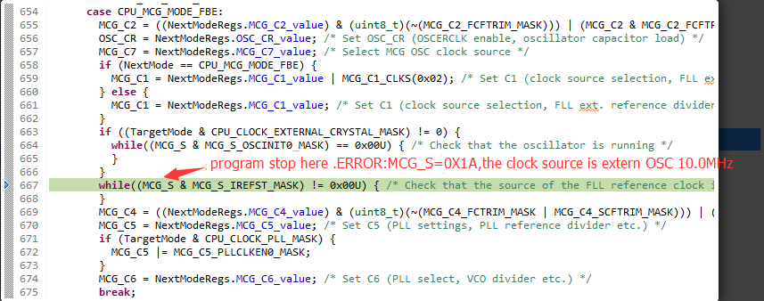

From the NXP_Kinetis_Bootloader_2_0_0 start and then jump to the APP failed, through the emulator to observe, the error at the following address (CPU_Init.c):

The following is a APP clock configuration:

Hi Andy,
Please try to replace the clock_switch() function in clock_config_K22F512.c with below one, hope it could be helpful:
