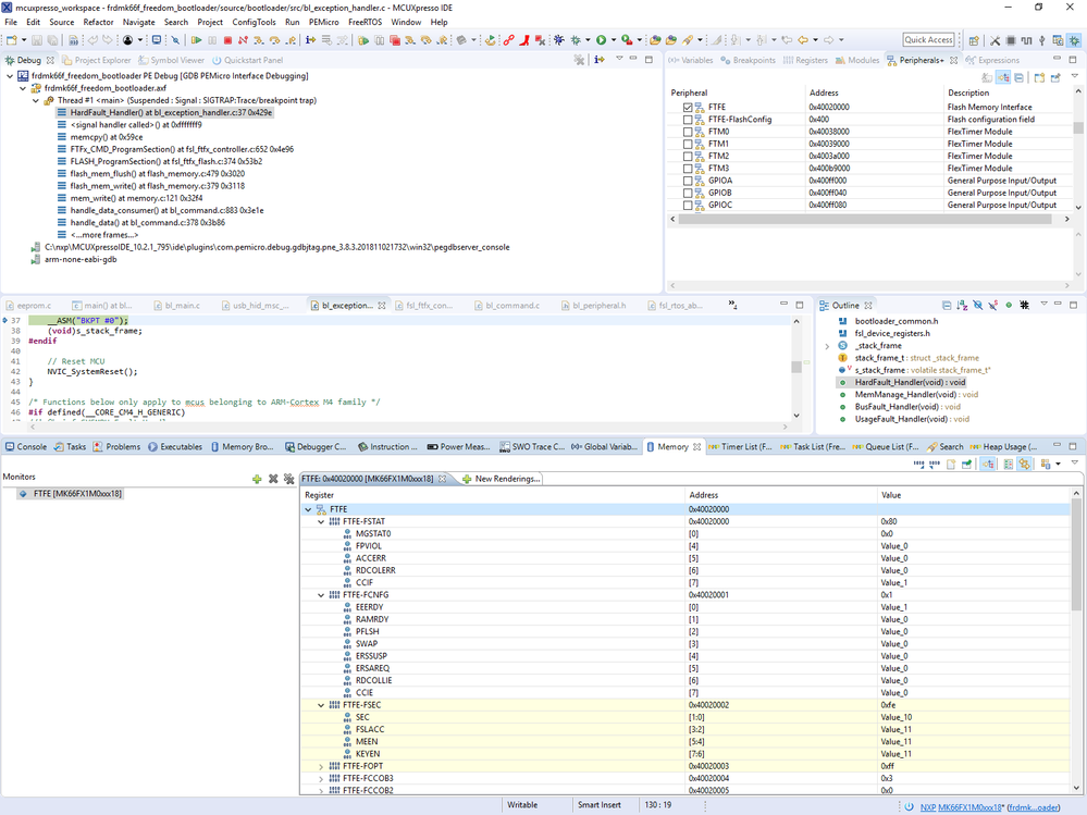

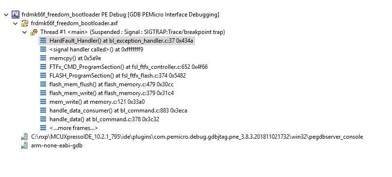

The MCUBOOT code works without any issues as long as the eeprom functionality is not configured either dynamically using the eeprom_initialization() from the Teensy core library, or configuring via the PE Micro Multilink Universal when programming the chip. But as soon as either eeprom_initalization() is run either in the application or in the bootloader, or if the chip is programmed with the eeprom enabled (no other changes to the code or configuration is done), attempting to updating of the application in flash using the bootloader will cause a HardFault and end up in the HardFault_Handler() when writing to flash (at latest at address 0xA3E0):
Rebooting the board will keep it in the bootloader, but reattempting flashing the application again will result in the same HardFault. When debugging, it seems like the program flash from address 0xA000 is correctly erased (set to all FF's).
I've checked the relevant registers both with eeprom enabled and not, and see no difference except from the registers defining the eeprom configuration. I've also verified that the system clock is set to 120 MHz. Doing a full erase and not programming the eeprom functionality gets the bootloader flashing working properly again.

  • I'm using MCUXpresso IDE v10.2.1 [Build 795] [2018-07-25].
  • The debugger is PE Micro Multilink Universal rev B with the latest firmware.
  • The main application us using a managed linker script, while the bootloader is using the manually configured linker file from the example project. The only change done to the bootloader linker script is that I've added the memory area for FlexNVM as described here: https://freescale.jiveon.com/docs/DOC-341716 to attempt to make the flashing work.

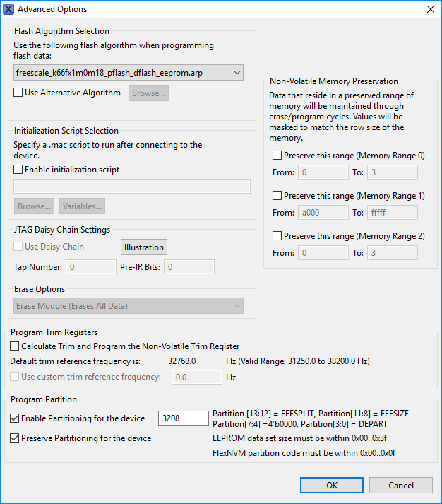

  • I'm using "EEE memory configuration example 2 — maximum EEE" as described on from page 8 in https://www.nxp.com/docs/en/application-note/AN4282.pdf. This means that the partition code is 3208:

the screenshot of the Advanced options is made by P&E and integrated into MCUXpresso. I'm not sure how it works. It says "EEPROM data set size must be within 0x00...0x3f". What does it mean? Can you try to read data flash 0 IFR map to see if the setting is correct? Sometimes incorrect setting may cause hardfault. For example, if the EEE size is configured as 32 bytes total, then read or write accesses to any addresses between 0x1400_0000 and 0x1400_001F are allowed, but 0x1400_0020 to 0x17FF_FFFF generates a bus error.
Also, please pay attention to 3.3.1 in AN4282, improper writing also cause hardfault.

The issue occurs after the FlexNVM has been configured to using it as eeprom and the register EEERDY in FTFE-FCNFG has been set. It happens both when using the P&E Micro Advanced options feature as shown in the picture in my first post or configuring it from the code using the program partitioning command, and if done either in the bootloader or application.

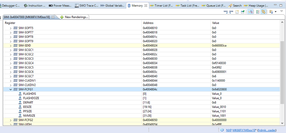

Anyway; here is a dump of the SIM-FCFG1 register when EEE is configured which according to my understanding seems to be correct:
So just to summarize; the issue is not reading/writing to eeprom, but as soon as FlexNVM is configured to be used as eeprom (EEERDY is set), when the bootloader attempts to write (a application) to flash from address 0xA000, a hardfault occurs. It has then successfully erased flash from 0xA000, so there is no application to jump to. The bootloader is still present and will run also after a reboot, but will not be able to flash a new application.

1. I see that hardfault happens at a memcopy() each time. Please check what/where/how long does it copy?

oystein_olsen_h
I've got it working now. It was a wrong configuration of the CPU type causing this. In the bootloader project preprocessor settings, "CPU_MK66FN2M0VMD18" and
"CPU_MK66FN2M0VMD18_cm4" were defined (i.e. the version w/o EEEPROM functionality and which is used in FRDM-K66F board), and not "CPU_MK66FX1M0VMD18 and "CPU_MK66FX1M0VMD18_cm4" as it should be.
In the function FTFx_CMD_ProgramSection(), I see that the FlexRAM is used for the data to be written to flash. The memcpy fails due to not being reconfigured to be used as RAM but instead as EEEPROM during flashing when using the incorrect CPU definition (the comment before the call to memcpy gave me the hint I needed).
