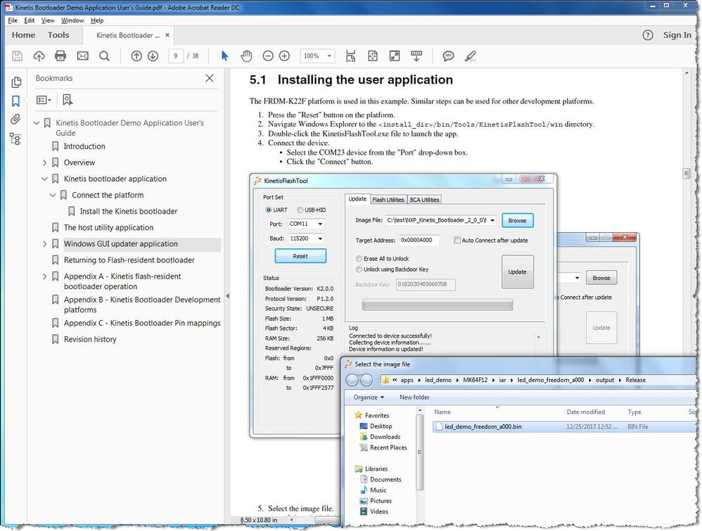

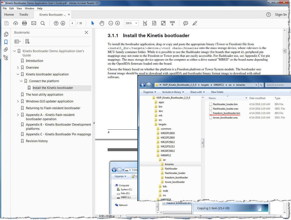

Robin_Shen
Follow the 'Kinetis Bootloader Demo Application User's Guide'.
first step:
3.1.1 Install the Kinetis bootloader
second step:
5.1 Installing the user application(build and generated by IAR)

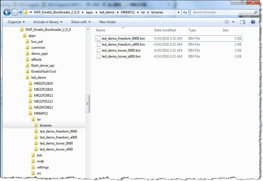

You can also use the led_demo_freedom_a000.bin file in C:\NXP_Kinetis_Bootloader_2_0_0\apps\led_demo\MK64F12\iar\binaries
Robin

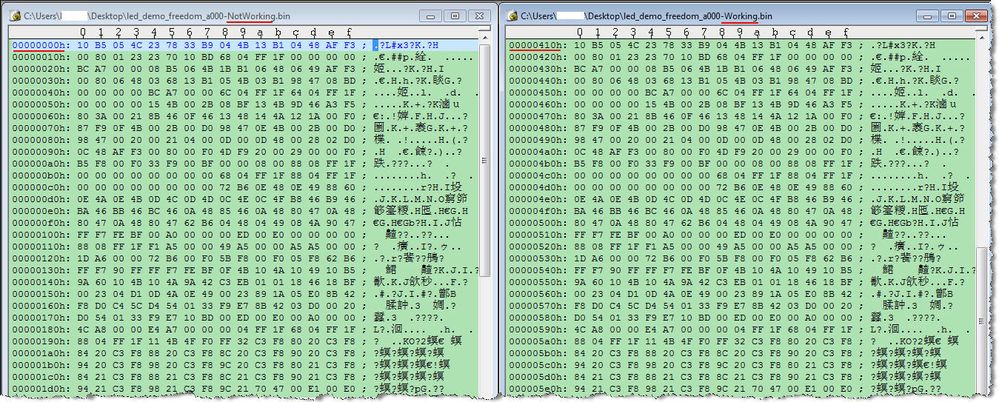

Robin_Shen
Please read the "Generate aligned HEX and S-record data output with GNU in KDS 3.2" generate binary file.
These two binary files are different, see the image shown below:
4,340 Views
roymessinger
Contributor V
Thanks, novice
This link is for generating aligned Hex and S-record file from ELF file. I need bin files for using KBOOT Blhost.exe (the 2 attached files are bin...).
I know the files are different. I've compared them too. I do not know the cause for that.
