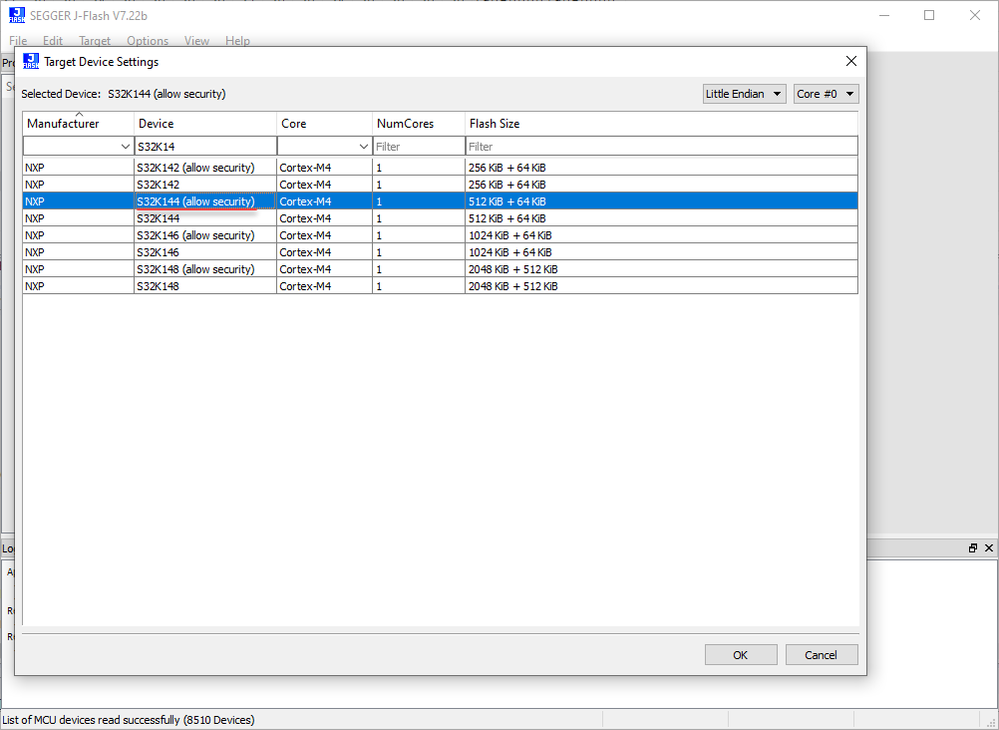

I am trying to update FSEC register to make my controller Secure.
/* Flash Configuration */
.section .FlashConfig, "a"
.long 0xFFFFFFFF /* 8 bytes backdoor comparison key */
.long 0xFFFFFFFF /* */
.long 0xFFFFFFFF /* 4 bytes program flash protection bytes */
.long 0xFFFF7FFF /* FDPROT:FEPROT:FOPT:FSEC(0xFF = secured) */
.text
.thumb
Even though; i have updated FSEC register in startup_S32K144.S file; And generated .hex file.
But While Software flashing; After doing Software Erase.
FSEC register value automatically updates from 0xFF to 0xFE
Please help me to resolve this issue.

Hi Sandipta,
Which IDE are you using?

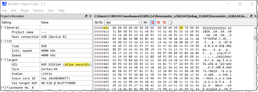

Modify the FSEC register in startup_S32K144.S file and generated .hex file by using S32 Design Studio for ARM Version 2.2, I was able to see the (0xFF = secured)
And then select allow security in J-Flash, you should be able to secure it.
Robin
