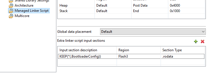

brunoalbrecht
I almost just found it! haha
On the "Extra linker script input section", add a new section for the interrupts:
Description: KEEP(*(.isr_vector))
Region: INTERRUPTS
Type: text
voilà!
The BCA is being correctly set on its address (0x3C0), BUT everything else is being put starting at 0x400, including the interrupt vector...

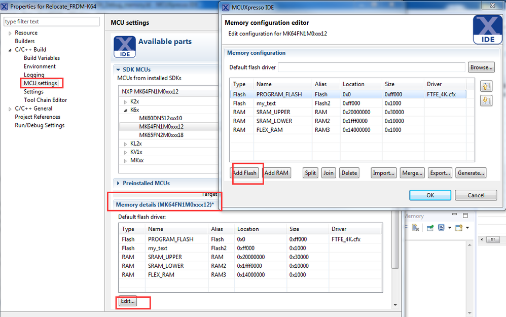

Hello Laci,
1. Please place the code of "
MEMORY
Rm_bootloader_config(X) : ORIGIN = 0x000003C0, LENGTH = 0x00000040
into the "xxx_memory.ld" file , for  project own MEMORY part  has includes this memory address part ,
so it overlap.
2. There also another method , using the "manage linker script" , add the memory section of "Rm_bootloader_config(X)"
in Memory details :
I attached a guide about how to relocate code in MCUXPresso IDE, it describe how to configure linker file.
Please check it .
Hope it helps
TIC

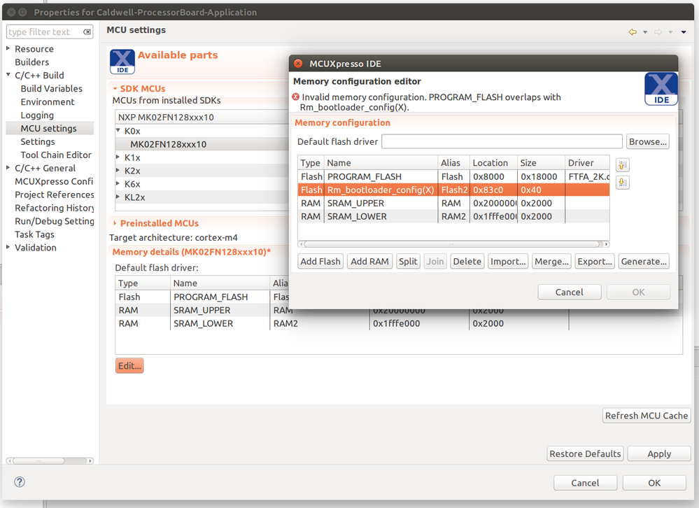

Hello Alice,
I am trying to use the MCUXpresso IDE memory configuration editor to add the bootloader configuration area (BCA) section to the memory map, but getting an "Invalid memory configuration" error due to overlap:
Have I followed your instructions above incorrectly? There is no mention of how to manage overlapping areas in the PDF you attached about "Relocating Code and Data Using MCUXpresso".
Thank you,
David
14,895件の閲覧回数
Hi David,
Of course it can't overlap.
From your screenshot , it overlap obviously.
Each section start address(Location) can't be includes in other sections.
If your Rm_bootloader_config  section want to start from 0x83c0, please reduce the Size of "PROGRAM_FLASH" to
0x3c0., then you can add another section like FASH2 after your " RM_bootloder_config" part from  0x8400 (0x83c0+0x40) .
Hope it helps
Alice

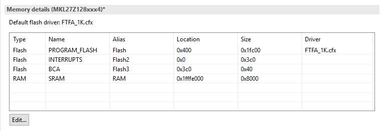

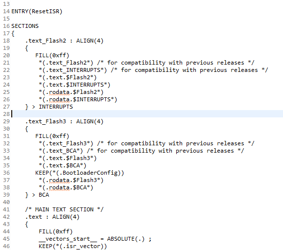

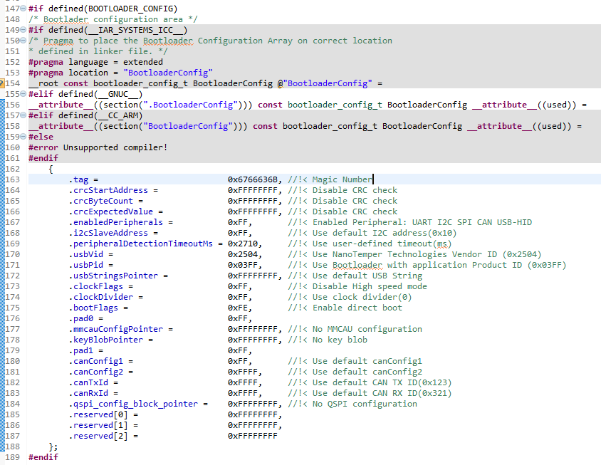

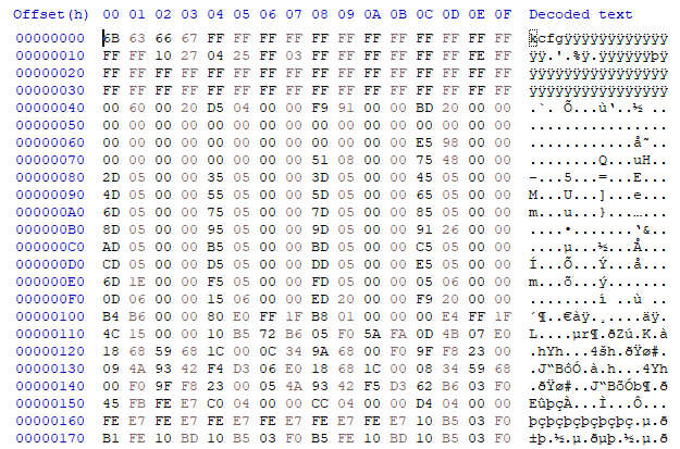

brunoalbrecht
any news on this matter? did you manage to have a working BCA area?
I can create the correct sections (PROGRAM_FLASH area first, then an INTERRUPT area to signal the space and then the BCA area) and even give it a name (under Project Properties -> C/C++ Build -> Settings -> Managed Linker Script, on the "Extra linker script input sections", I added a "KEEP(*(.BootloaderConfig))" on the BCA region as a .rodata). The project compiles fine, but if I check the binary file created, my BCA data is being placed on the address 0x0!
Memory sections:
Extra linker script input section:
Linker file automatically created:
Bootloader section declaration:
and the binary file (note the "kcfg" in the beginning of the file)
14,895件の閲覧回数
