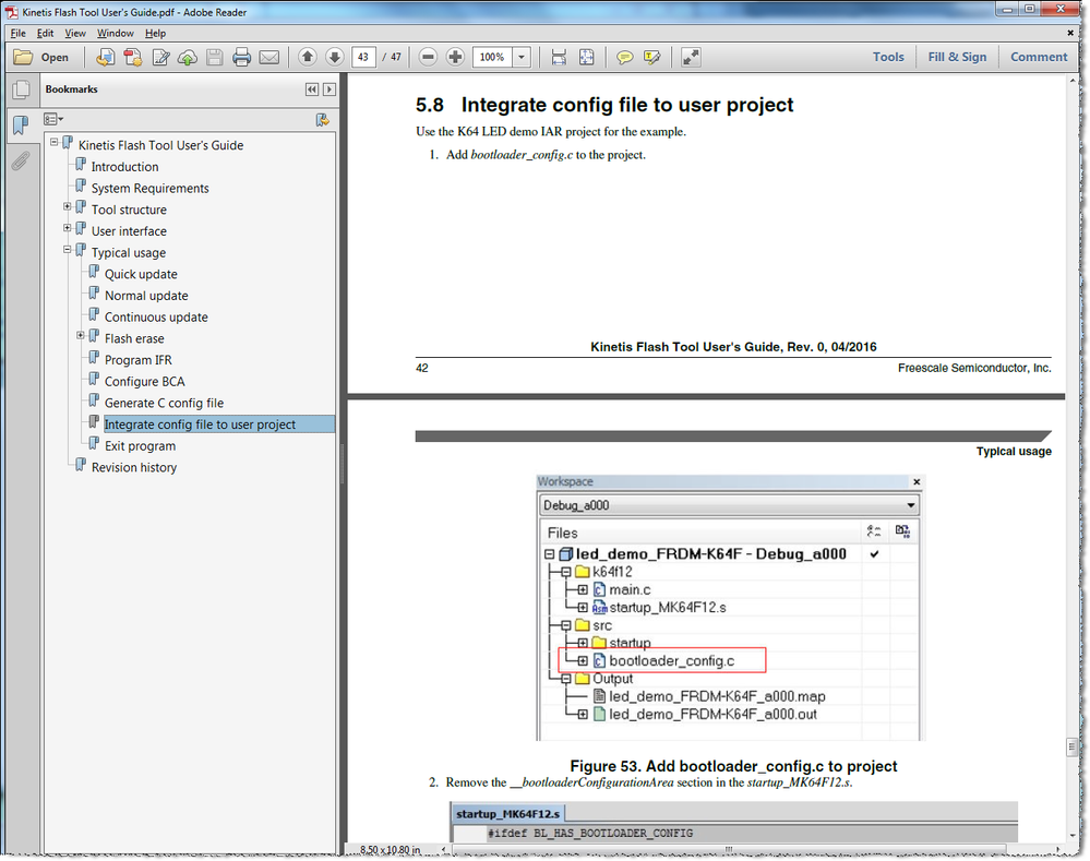

Robin_Shen
Please refer the "5.8 Integrate config file to user project" of Kinetis Flash Tool User's Guide.
Robin

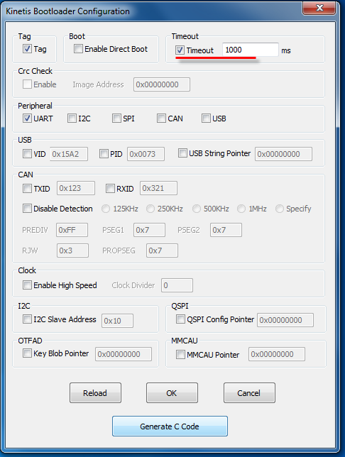

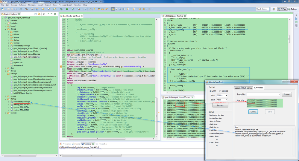

laszlomonda
Contributor V
Thanks Robin! I was aware of the Kinetis Flash tool, but I didn't know it can generate the BCA. In the meantime, I generated the BCA C file and adapted it to the KL03, and still, it doesn't work.
Please take a look at my BootloaderConfig variable and linker script.
The bootloader always times out after the default 5 seconds instead of the specified 1 second. It's like the bootloader ignores the BCA. Do you have any ideas why?
Thank you very much in advance!
- Laci

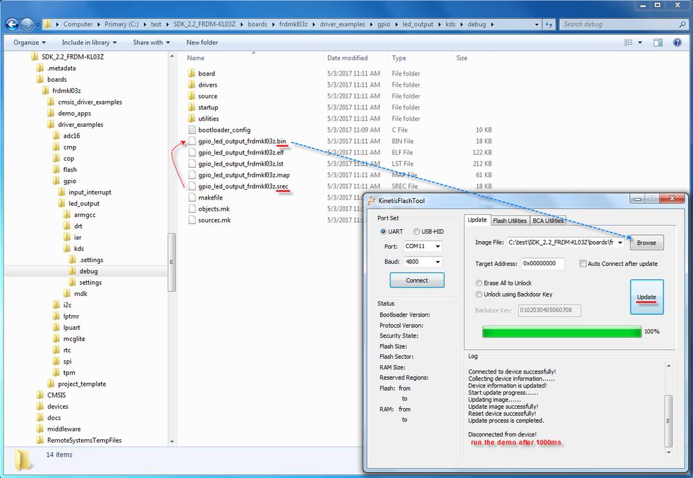

Robin_Shen
Sorry for the late reply!
Please check the srec(bin) file: if the BCA data is write into the srec file.
I test the led_output demo with KDS(C:\test\SDK_2.2_FRDM-KL03Z\boards\frdmkl03z\driver_examples\gpio\led_output\kds\...)
The LED will toggle after timeout(1000ms), Update the bin(srec)file by using KinetisFlashTool.
Robin

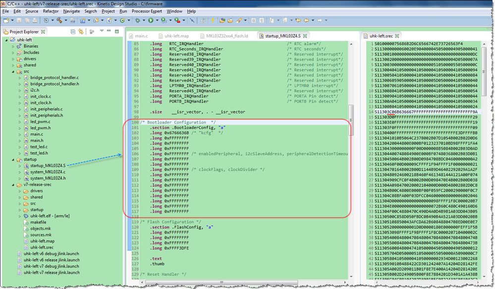

Robin_Shen
Hi Laci,
After add BootloaderConfig section in the startup_MKL03Z4.S file, you can see it in srec file.
Robin
