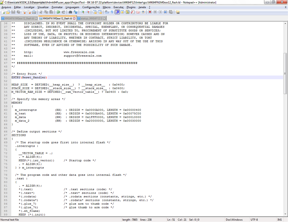

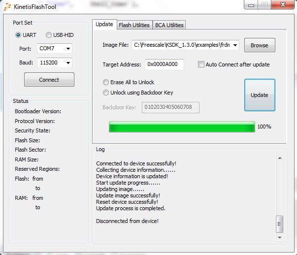

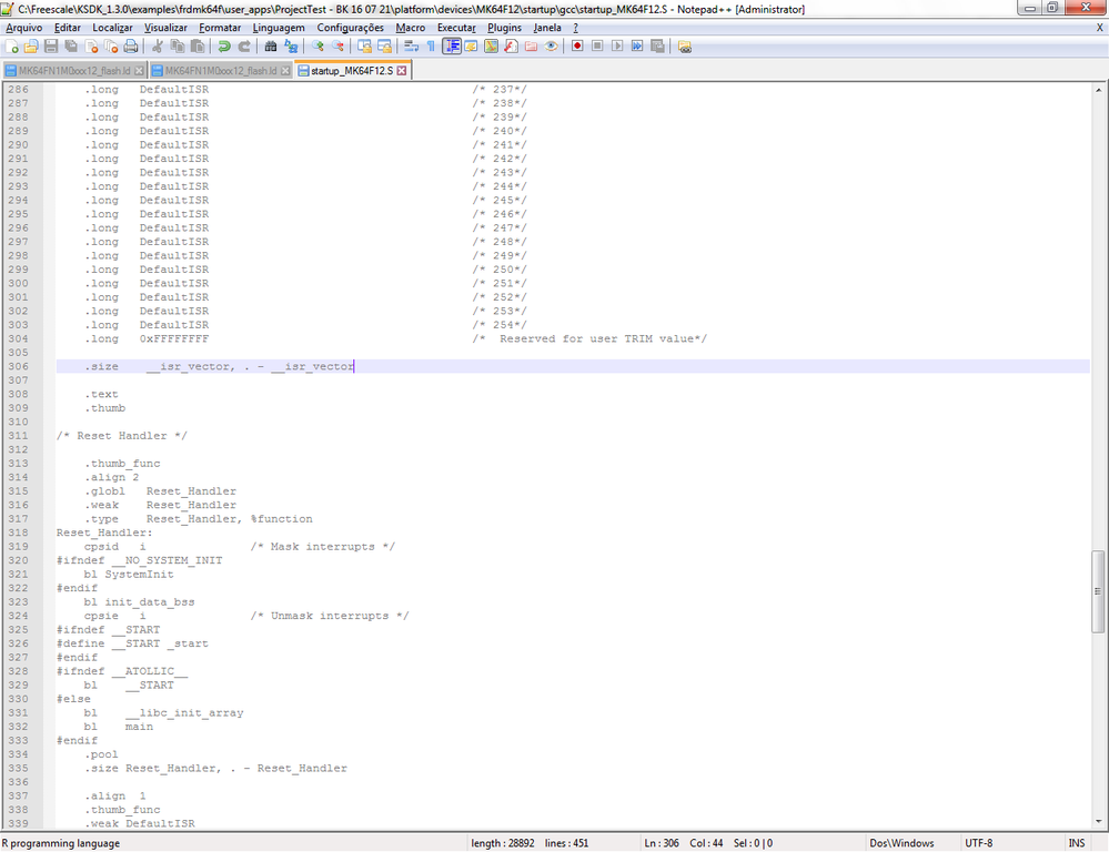

I have followed the steps described in the file annexed to this message. I am using the code previously generated by the KSDK-Project-Generator for KSDK 1.3.
I retried with one example of the KSDK folder, and it work just fine. Then, i have retried to do the procedure with my project, but again the bootloader keeps running and the code wrote by my do not start. Here is some images that can help you understand my situation:
