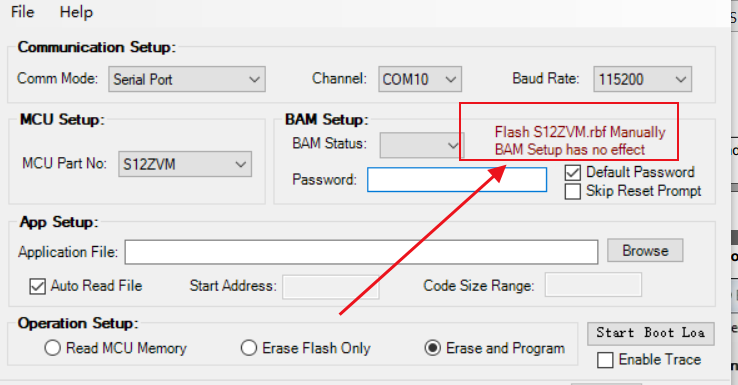

Flash S12ZVM.rbf manually BAM Setup has no effect

Could somebody tell me how to deal this problem?
Thank you!

Could you please clarify your issue? Did you follow any instructions?
Are you using RappID Bootloader Utility for Model Based Design applications?

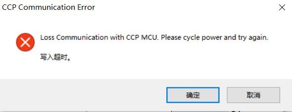

I just can't download my code into EVB,and it showed :
I made it ever, however I can't now.Could you give me some advice?

constantinrazva
Hello again niequanwei@aochutec.com‌,
I have a question about your setup: did you download the .rbf manually (through S32 Design Studio) before trying to download the ELF through RappidTool? That would be the 1st step to take.

constantinrazva
Hello niequanwei@aochutec.com‌,
I think you should ask on the Code Warrior community (here) to get an answer from more experienced guys when it comes to Code Warrior. Just keep in mind to mention that you'll probably have a custom linker file and a custom makefile, if you want to use the code generated by Model-Based Design Toolbox.
As far as downloading through the RappidTool, you can do it after you manage to generate the .ELF file, but keep in mind that first you'll have to flash the .rbf onto the board, and only then download your application.

constantinrazva
And one more question niequanwei@aochutec.com‌,
Did you change any jumpers on the board? Because from what I understand, it worked in the past.

constantinrazva
Can you share with us the project that you want to upload?
If you're using the Model-Based Design Toolbox for S12ZVM to build your project, mcd_main.c file is of interest, as there are a few variables like APP, DELAY, APPLOC that may affect the uploading via rappid tool.
