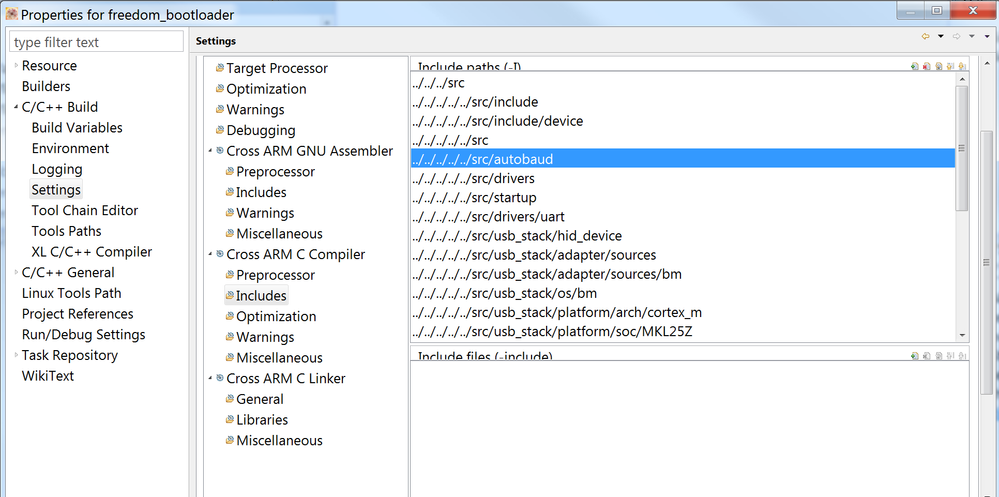

5. I checked the step you mentioned CPU "CPU_MKL26Z256VLH4" changed project property-> c/c++ build ->setting -> cross ARM c compiler -> Preprocessor ->debug symbols, the tool was defaulted to DEBUG anyway

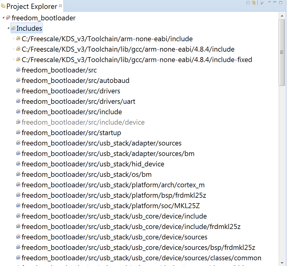

6. Create a new project in KDS by importing the modified Kboot v2 (after step 1->4)

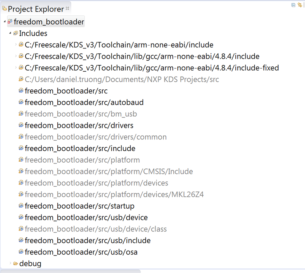

7. Changed the setting of some paths under Projects->Properties->C/C++ Build->Settings
8. However, I still got a lot of errors in compiling. Here are what I got:
As you can see, there are some de-highlighted paths in the Project Explorer window which the tool either:
1. can't find them because they don't exist, such as C:/Users/daniel.truong/Documents/NXP KDS Projects/src
OR
2. in the case the paths exist, there must be some kind of problem, such as freedom_bootloader/src/platform, etc
For problem 1., I went through all the menus/tabs/windows I could find inside the KDS. I could not spot anything that points to the path above. Perhaps it was hidden somewhere in some *.h file.
For problem 2., I have no idea why the tool is not happy about those paths. Maybe the setup is still not right.

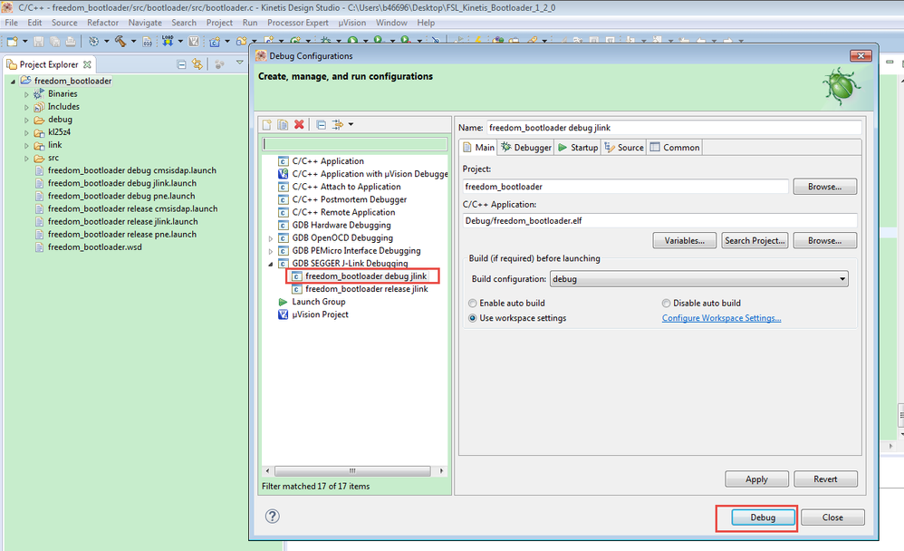

First of all, thank you so much for giving a pointer on the User Guide pdf, as well as all the details that I need to get started on the right track.

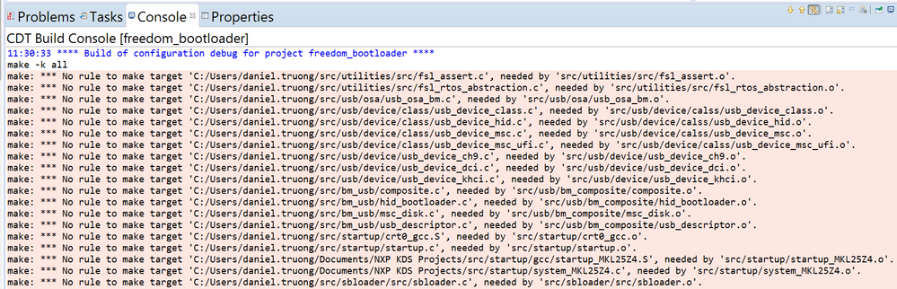

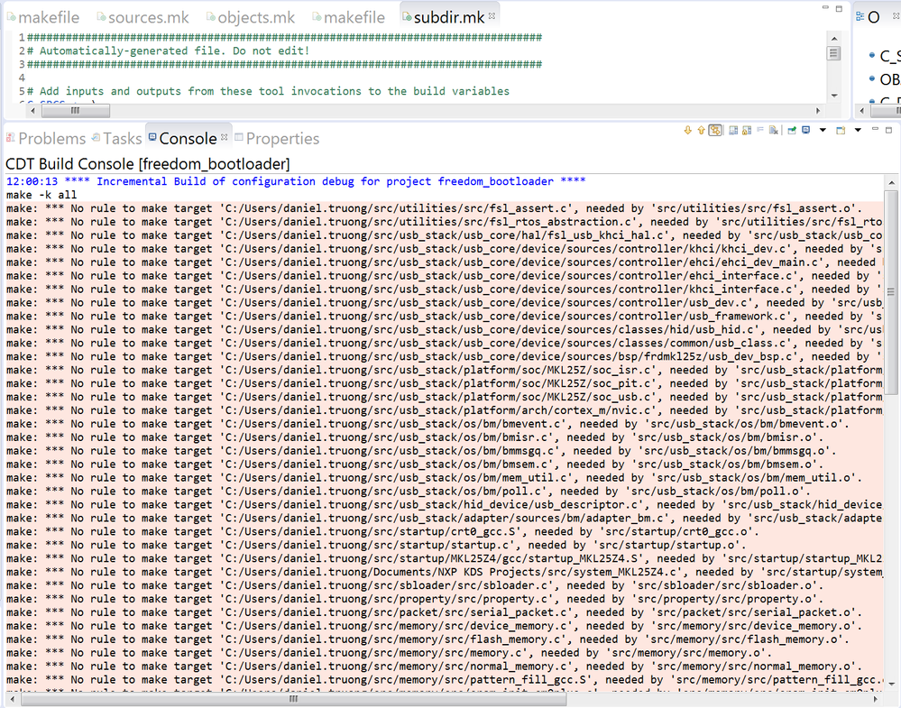

However, I encountered a problem in step 2 when I tried to download the bootloader into my board.
I used the same Debug Configuration launch as yours because I also used a J-Link debugger via SWO header to the board. It failed to launch with message "errors existed in active configuration".
There are a lot errors of the following type shown on the console (only 4 of many are listed)
make -k all
make: *** No rule to make target 'C:/Users/daniel.truong/src/utilities/src/fsl_assert.c', needed by 'src/utilities/src/fsl_assert.o'.
make: *** No rule to make target 'C:/Users/daniel.truong/src/utilities/src/fsl_rtos_abstraction.c', needed by 'src/utilities/src/fsl_rtos_abstraction.o'.
make: *** No rule to make target 'C:/Users/daniel.truong/src/usb_stack/usb_core/hal/fsl_usb_khci_hal.c', needed by 'src/usb_stack/usb_core/hal/fsl_usb_khci_hal.o'.
make: *** No rule to make target 'C:/Users/daniel.truong/src/usb_stack/usb_core/device/sources/controller/khci/khci_dev.c', needed by 'src/usb_stack/usb_core/device/sources/controller/khci/khci_dev.o'.
I'm wondering whether or not it's due to the conflict in Kinetis families. I noticed there are a lot of "kl25z4" notation in the bootloader whereas my board is KL26Z-based ? That prompts me with the following questions:

kerryzhou
Hi Daniel Truong,
     Now answer your several questions:
1. build errors.
   Did you use my attached project directly?
   Your problem should caused by missing the source file, or the headfile in the include path.
2. KL25 in the project.
KL25's code can run in KL26 directly, to the uart flash bootloader, it is the same, KL26 can downward compatible with KL25.

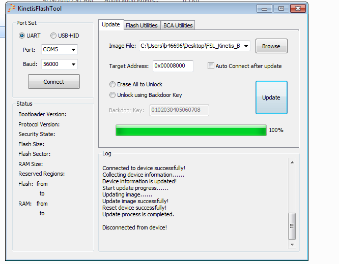

4. decision whether to enter "bootload mode" or to jump to user application
You can find these functions in the uart bootloader which I give you before. These function should in the bootloader, not the in application code.
After power up, the code will enter bootloader code automatically, then it will wait you update the application code, if you didn't update the application code, after timer out, it will jump to the user application code. If you want to decide it, you just need to printf some data in the bootloader or the app to check it.
Wish it helps you!

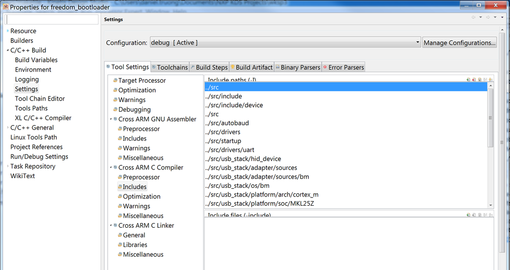

4. In KDS, I imported the existing project at the root directory (FSL_Kinetis_Bootloader_1_2_0/targets/MKL25Z4/kds) into my workspace (only freedom_bootloader box checked, tower_bootloader box unchecked)
5. Immediately upon importing this project, I see a lot of paths in the "freedom_bootloader/Includes" directory in the Project Explorer are de-highlighed signaling these paths are wrong already.
The reason for this is under Project->Properties->C/C++ Build/Settings, the paths were set up like this:
6. So I changed all of them to this (to match the hierarchy in KDS - I made a copy inside my workspace while importing). Capture3.PNG
After I did this, all paths in the Includes dir were back highlighted, EXCEPT one as follows:
As you can see, there is still something wrong with the path "src/include/device" although the path exists. Maybe there is something to do with the new folder I copied in there in step 3 above.
7. I tried to rebuild the project again but still got the following errors:
Apparently, somewhere the make file defines the paths for these files the way they are shown. Obviously the errors are due to the wrong paths (there is no "src" directory under "C:/Users/daniel.truong/"). I just don't know how to change the setting to correct these paths. Can you please help?

1. You can use the debugger to download the code to your KL26 board. The debugger can be JLINK, opensda to download the bootloader to the chip.
   My board is using JLINK firmware:
2. Use KDS open :FSL_Kinetis_Bootloader_1_2_0\targets\MKL25Z4\kds\freedom_bootloader
  Please use my attached Kboot for KL26.
Because I am using the JLINK debugger, so choose JLINK file to download. And exit the debug mode,then the bootloader code has downloaded to the board.

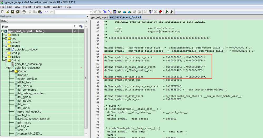

3. Modify the application code.
 I am using the KSDK2.0-FRDM-KL26 code as the application code, and modify the offset address to 0x8000, because the bootloader already define the app address to 0x8000;
Application source code folder:
SDK_2.0_FRDM-KL26Z\boards\frdmkl26z\driver_examples\gpio\led_output
Now modify the link file to change the application start address, take IAR project link file as an example:
Change the interrupt start, text start to base 0x8000, instead of the 0x0000;
Generate the bin file. I have attached the modified bin file in :FSL_Kinetis_Bootloader_1_2_0\KinetisFlashTool\win\KL25\gpio_led_output_0x8000.bin
4. open FSL_Kinetis_Bootloader_1_2_0\KinetisFlashTool\win\KinetisFlashTool
(1) Browse
  Choose FSL_Kinetis_Bootloader_1_2_0\KinetisFlashTool\win\KL25\gpio_led_output_0x8000.bin
(2) Target address
 Choose 0X8000
(3) Choose port as your board's COM in the PC, then click connect.
(4) Click Update button.
You will find the code is updated to the chip with uart bootloader.
Now my board is blinking the red light which is the function of the application code.
Wish  it helps you!
