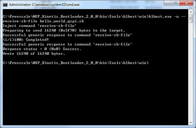

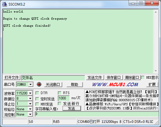

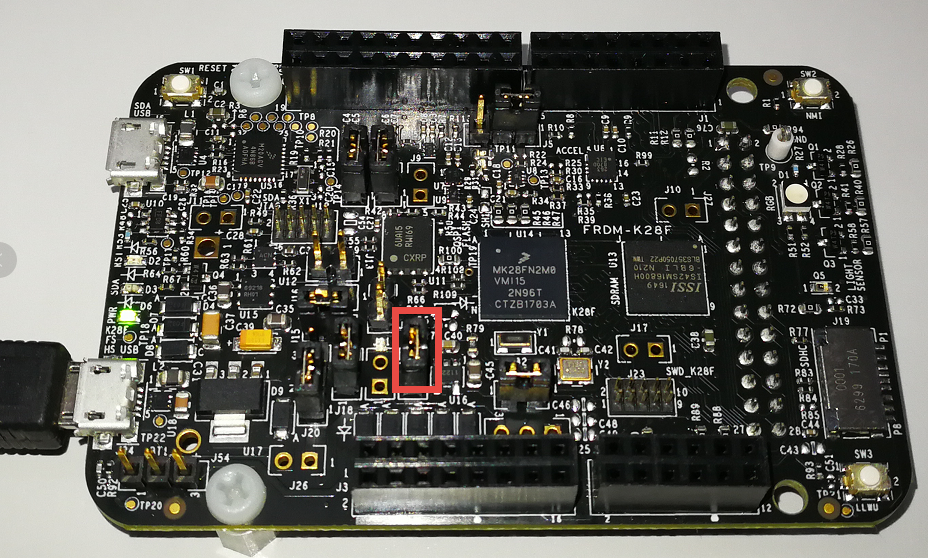

Please check attached <readme.txt> file, which indicate that:
On the FRDM-K28 board, the user can use the USB port to download the demo program through blhost.
I checked the FRDM-K28F board user guide, the default USB port is USB HS:
The ROM bootloader is using USB FS, please short the J53 jumper.
After that, I could use blhost with below command to download the bd file:
blhost.exe -u -- receive-sb-file hello_world_qspi.sb
After that, I could get [hello_world_qspi] demo run.
I also attached my test using [hello_world_qspi] demo image and related files for your reference.
Wish it helps.

Thank you for your detailed setup notes and picture of your FRDM-K28F. On my board, J53 was open and J14 was shorted, otherwise, all jumpers matched yours. I was also attempting to communicate thru the OpenSDA port. I switched to the MCU USB port as you showed above and set my jumpers to match your board.
At first, I ran into the same issues with the board:
blhost.exe -u -- get-property 1
Error: UsbHidPeripheral() cannot open USB HID device (vid=0x15a2, pid=0x0073, sn=).
I tried another FRDM-K28F board with the same jumper settings and that board worked:
Inject command 'get-property'
Response status = 0 (0x0) Success.
Response word 1 = 1258422272 (0x4b020000)
Current Version = K2.0.0
I went back to my original board, reloaded a demo project to the board from the SDK (qspi polling demo) and power cycled it with the SW2 press/release sequence and at this point I got a response with blhost. I'm guessing my FRDM-K28F got placed in a bad state when I experimented with the flash config block and the bootloader config area.

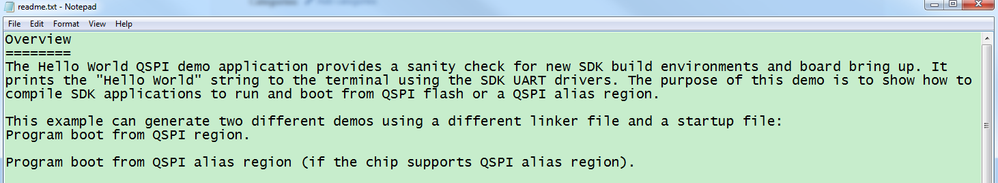

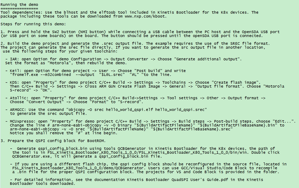

The new MCUXpresso SDK V2.3 for FRDM-K28F will provide the [hello_world_qspi] demo soon.
You could find the similar demo at MCUXpresso SDK V2.2 software package for FRDM-K82F board.
..\SDK_2.2_FRDM-K82F\boards\frdmk82f\demo_apps\hello_world_qspi
The [hello_world_qspi] demo  Overview and how to run:
Wish it helps.
