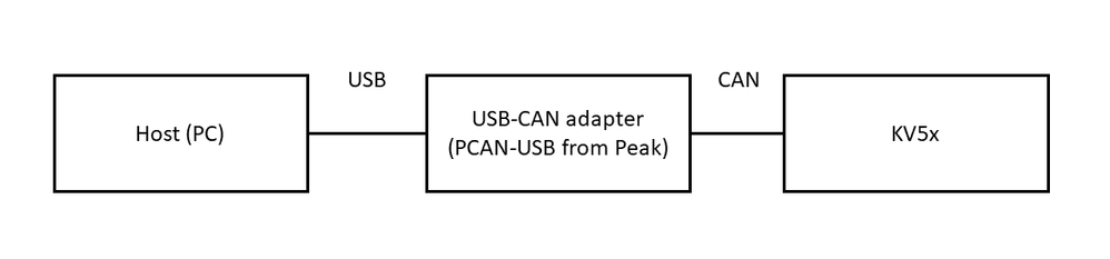

I would like to use a kinetis kv5x chip because it has a CAN bootloader integrated.
But, despite my researches, I don't understand very well how to use it.
So before to purchase one, I would like to know how it works. Is the bootloader already in the board or should I tranfer it by myself ? According to the chapter 14 of the KV5x ref manual, it seems to be already programed but I read AN and topics from users who had to program by themselves the bootloader.
If I link the board to the host PC, with a CAN adapter like the PCAN-USB from Peak System,
will the flash tool utility or the mfgtool detect the board and automatically allows me to transfer my bin file through CAN Bus ? By the way, these utilities allows to tranfer bin file by CAN or do I need any other soft ?
Or maybe, it will understand the Board is connected by USB,  or perhaps not detected at all ?
Any other advice who could help me understand how bootloader CAN works will be appreciated.##

flashloader: This subproject is the core of project. This subproject is laid in RAM. Because when implementing flash operation, code must be laid in RAM. When boot up, flashloader_loader/tower_bootloader copys flashloader's image to ram.
flashloader_loader: If you don't want to keep bootloader after download application, you can use this subproject. This code is laid in flash address0, and can be covered when download application.
tower_bootloader/freedom_bootloader: If you want to keep bootloader after download application, you should use this subproject.
mfgtool/blhost/KinetisFlashTool can only support UART/USB. If you want to use other port like I2C/CAN/SPI, please see the Embedded Host User's Guide.pdf in KBOOT package.
Jing
3,797 Views
jingpan
KV58 hasn't ROM bootlaoder as you can see at the start of chapter 14. But KV58 has been pre-programmed a flashloader in Flash. This flashloader is one time using. When KV58 running, it copy a bootloader image into RAM and the bootloader waiting for mfgtool/blhost/KinetisFlashTool's connection. When you download your own application via these tools, the flashloader is covered by the application's image.
I'm not sure if the USB-CAN adapter can work. But on the other hand USB-Serial adapter can work. Because for computer, the adapter is just like a serial port.
mfgtool/blhost/KinetisFlashTool can accept bin/hex/s19/srec file.
You can download the flashloader source code from MCU Bootloader|NXP
Jing
