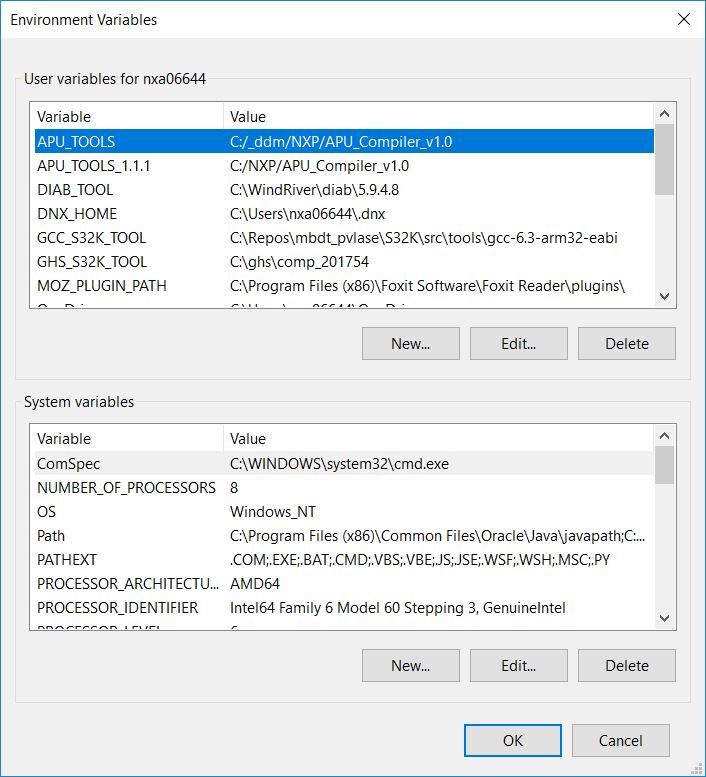

I am new to using the SBC-S32V234 Board and I would like to be able to do the configuration with Matlab.
I have installed all the necessary tools so far. But I do not know how to perform the configuration of
APU_TOOLS = C: /NXP/APU_Compiler_v1.0
S32V234_SDK_ROOT = C: / NXP / VisionSDK_S32V2xx_RTM_1_1_1 / s32v234_sdk.
3,114件の閲覧回数
paulvlase
Hi willcampo@hotmail.com,

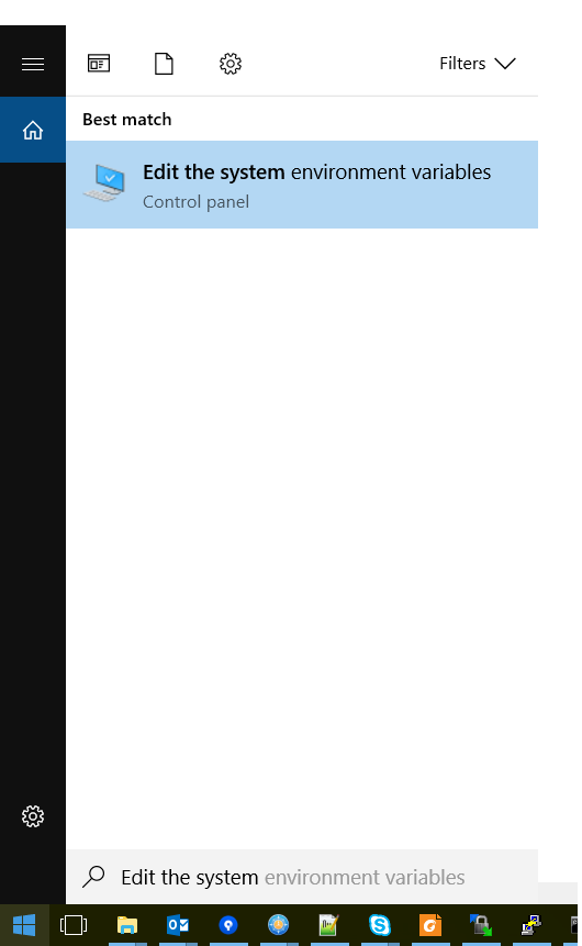

You have to set APU_TOOLS and S32V234_SDK_ROOT as environment variables.
1. If you use Windows 10, open Start menu and type "Edit the system environment variables"

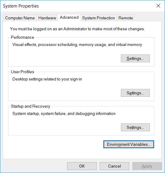

2. In the newly open "System Properties" window click on "Environment Variables" button.
3. Another window will open, named "Environment Variables". In this window you can add a new environment variable by pressing "New" button.
You can find the instructions for other versions of Windows operating system on https://www.computerhope.com/issues/ch000549.htm .
