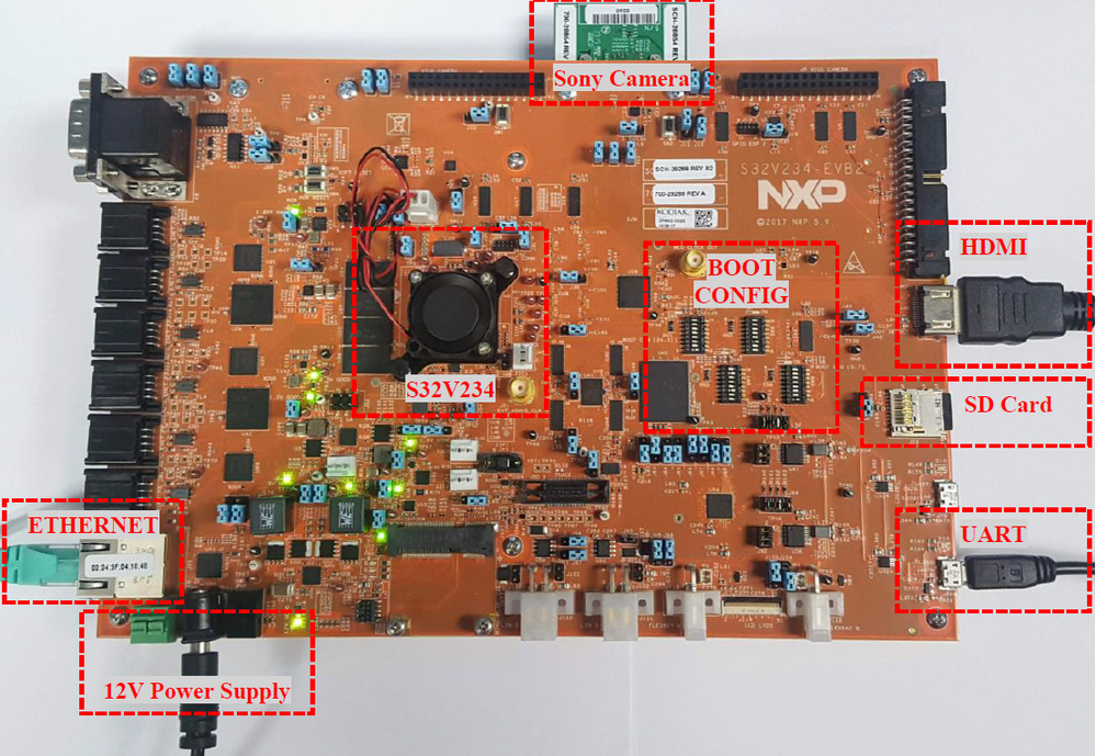

Daniel_Popa
Hi abhay.kumar@lnttechservices.com‌,
Are you using this board ?
and these boot settings ?
