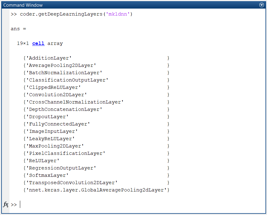

I am currently evaluating on how the S32V234 can be used for running neural networks. The provided CNN Matlab examples work pretty well on my dev-board. What I could not find was an example for a neural network that does not use an image as the input (but e.g. numbers), so I wonder what the recommended way is to use such networks.
  • Can I just use any neural network in Matlab and compile it for the S32V234 with nxpvt_codegen(…)?
  • Can I use any layers/neural network types I want?
  • Is there example code I overlooked?
  • Is there a better way to do this, other than Matlab?
  • If I do not use any of the nxpvt.apexcv.xxx commands the compiled program will solely run on the ARM processor?
  • Does the Vision Toolbox support the integrated Vivante GPU in any way?

Q2: Can I use any layers/neural network types I want?
You can use most of them. The complete list can be found on the MathWorks site here: https://www.mathworks.com/help/coder/ug/networks-and-layers-supported-for-c-code-generation.html#mw_...
You can also use MATLAB command prompt to get a list of layers with the command:
