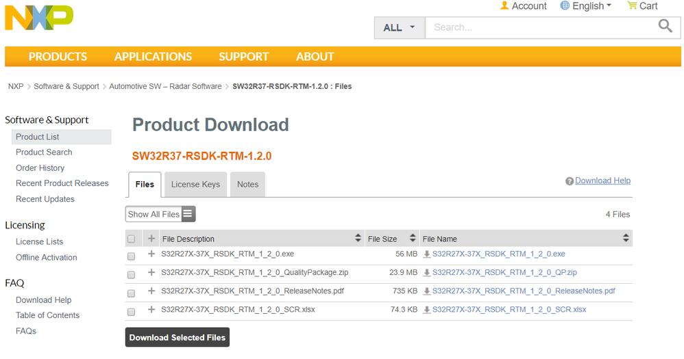

What is the latest version of the Radar SDK? Is there a newer version than SW32R37-RSDK-RTM-1.1.1?
Thank you!
8 Replies
2,694 Views
Daniel_Popa
Hi Jane,
The latest one is  RTM-1.1.1
2,694 Views
Daniel_Popa
Version 1.2.0 is now available here

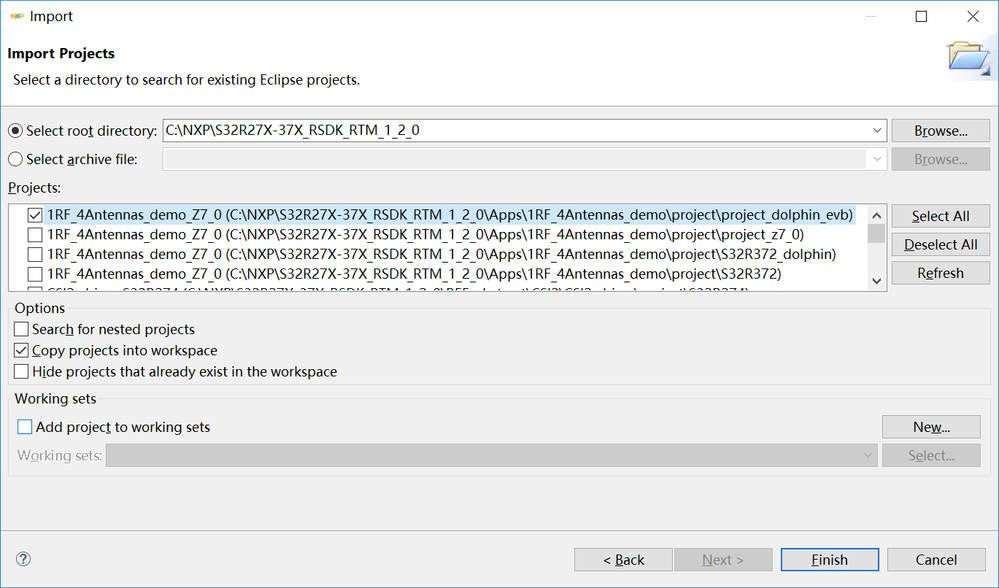

I have installed S32R27X-37X_RSDK_RTM_1_2_0, I want to use DCC development kit run 1RF 4Antennas Demo, Which project should I use?

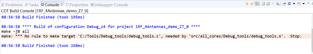

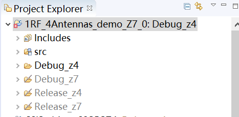

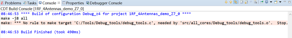

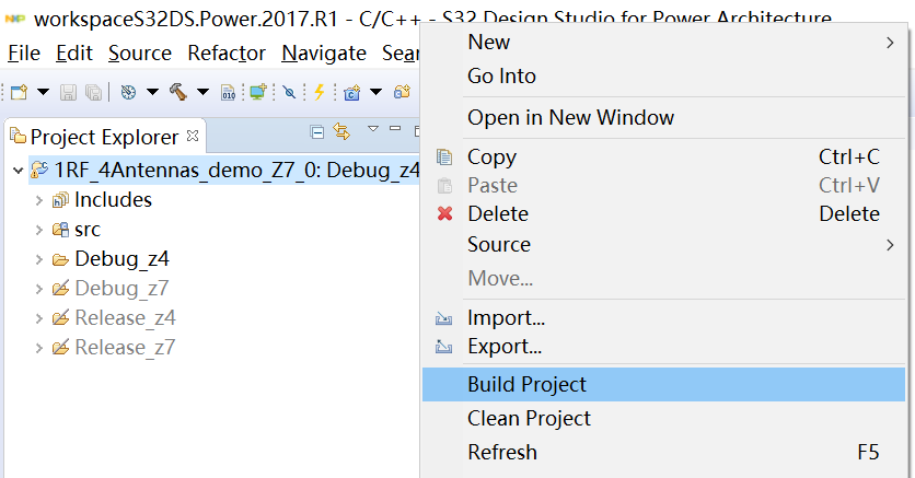

jane_yu
Hi Daniel,
1RF 4Antennas Demo. An error occurs when I built the project,Can you tell me where the problem is?
Thank you!

b13310
could you please clarify for me what method you used to import project - if you had "copy project into workspace" checked?

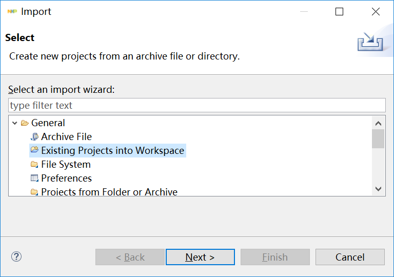

jane_yu
Hi Irina,
I had "copy project into workspace" checked,the method I import project as follows:
2,694 Views

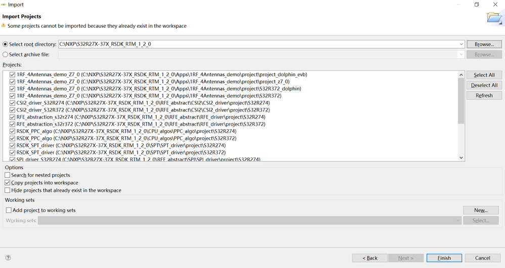

b13310
this is what I suspect.
Could you please try to import it again without this option checked (you would need either remove project you already imported, or use new workspace)
