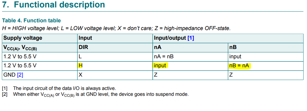

For the last question, I think they used for U1 a transceiver with two level shifters because for the UART_TX_MCU and the other signal the direction is always from B to A like in the Table attached. So there was no need to put two components with the DIR connected directly to ground from two signals.

In viewing the schematic for the OpenSDA circuit used in the FRDM-K22F (Sheet 4, "OpenSDA Interface"), the level-shifter U2 has its direction pin (DIR, pin 5) tied between 10k/GND and 4.7k/3.3V. This brings it to about 2.24V. It is connected to a net titled SDA_RX_EN, but that net shows up nowhere else throughout the multi-page schematic, so apparently it is just a label with no external driving factor influencing it, meaning it just stays hovering at 2.24V. pastedImage_1.png
The datasheet for the 74LVCH1T45 (U2) specifies that the DIR input for VCCI between 3.0V and 3.6V is a 2.0V minimum. For an application where VCCI is 3.3V, having DIR tied to 2.24V is uncomfortably close to the 2.0V edge case, especially if for no particular reason.
U2 follows a slightly different pattern than U11 and U6 since its DIR pin is being tied manually and not toggled digitally by an external pin (recall that the net it's attached to connects to nothing else in the design, even across other Freedom board designs).
So why would this pin not be tied to a solid high (P3V3_SDA) or solid low (GND)? Wouldn't residing near an edge case only be a risk for trouble? Is there something else I might be missing about this?

Also is the reasoning for different part number on the one level shifter just to get another channel?
