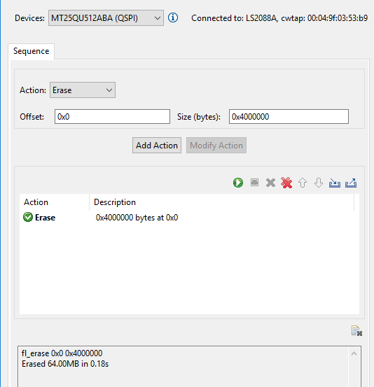

Thanks very much for your reply. The items1 and 2 all have set,  and I found if reopen the CW IDE and our board, this error disappeared some times.  now I meet next question, the qspi flash is programmed failed, it seems the flash can not be erased clean. when use erase command, it only need 0.18s.
log:
fl_erase 0x0 0x4000000
Erased 64.00MB in 0.18s
fl_erase 0x0 0x2000000
Erased 32.00MB in 0.08s
fl_write 0x0 "C:\Users\Fred.shiao\Desktop\qspi-config2.img"
Wrote "C:/Users/Fred.shiao/Desktop/qspi-config2.img" in 162.47s
fl_verify 0x0 "C:\Users\Fred.shiao\Desktop\qspi-config2.img" -s 0x4000000
Error: size requested exceeds the size of the file.
fl_verify 0x0 "C:\Users\Fred.shiao\Desktop\qspi-config2.img" -s 0x2000000
Expecting 0x55 but found 0xff at offset 0x0
Expecting 0xaa but found 0xff at offset 0x1
Expecting 0x55 but found 0xff at offset 0x2
Expecting 0xaa but found 0xff at offset 0x3
Expecting 0x00 but found 0xff at offset 0x4
Expecting 0x00 but found 0xff at offset 0x5
Expecting 0x10 but found 0xff at offset 0x6
Expecting 0x80 but found 0xff at offset 0x7
Expecting 0x40 but found 0xff at offset 0x8
Expecting 0x40 but found 0xff at offset 0x9
Verify failed from 0x0

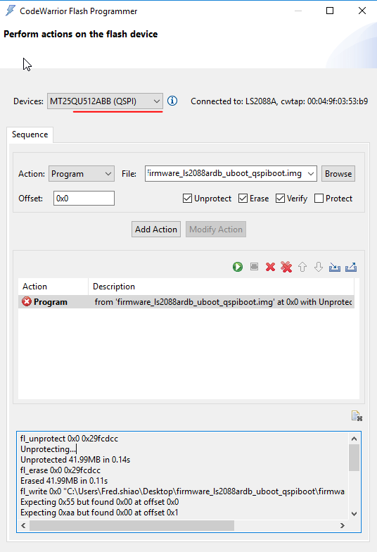

We use CodeWarrior for ARMv8 v2020.06, qspi flash type is  MT25QU512ABB8ESF-0AAT, we can only find MT25QU512ABA instead of MT25QU512ABB.

QiujuYe
Hi yipingwang,
I have modified the target initialization file,  but still erase and program failed.
USE_SAFE_RCW = False   -> USE_SAFE_RCW = True
QSPI_BOOT = 0   -> QSPI_BOOT = 1
if QSPI_BOOT:
        # Add QSPI device
#        fl.add_device({"alias": "qspi", "name": "S25FS512S", "address": 0x20000000, "ws_address": 0x18000000, "ws_size": 0x1FFFF, "geometry": "8x1", "controller": "QSPI"})
        fl.add_device({"alias": "qspi", "name": "MT25QU512ABA", "address": 0x20000000, "ws_address": 0x18000000, "ws_size": 0x1FFFF, "geometry": "8x1", "controller": "QSPI"})
otherwise, we use flash type is MT25QU512ABB, we also try to add flash drive, add file MT25QU512ABB.xml, but have the same problem.

Please refer to the following suggestion from the AE team.
This flash device was used on NXP parts which suggests  me that there isn't an algorithm issue in the CW.(at least from the point of view of the customers that had those devices)
If the client tries a sequence as(in the debugger console):
fl_id
fl_erase offset 0x100
fl_dump offset 0x100
fl_write offset 0xabcdeab
what errors does he see for the above commands?
To run the above sequence:
- save the init script.(and make it the active script)
- click on the "Connect" button (near the Inspect button)
- once there is an active connection to the board, open Debugger Console and type one of the above commands.(for fl_id it does not matter if you do not see the actual id; the idea is that the command must not fail)
Is there any offset that works?
For example:
-first range
0 - FFFFFF
-second range
01000000h - 01FFFFFFh
-third range
02000000h - 02FFFFFFh
-fourth range
03000000h - 03FFFFFFh
(these ranges are taken from DS)
Note: MT25QU512ABB Is compatible MT25QU512ABA- the difference  is just the revision number.
Another suggestion is to check with a logical analyzer the commands sent / received from the device.
7,832 Views
