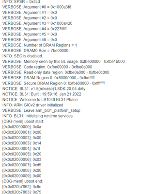

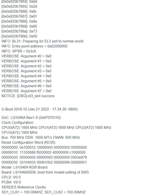

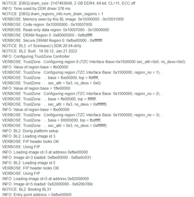

ls1046a: long time to load/print uboot!
1,101 Views
Rainight
1,036 Views
Rainight
I solevd it, it related to USB erratum in uboot code about soc.
1,037 Views
Rainight
1,084 Views
yipingwang
Please use QCVS DDRv tool to connect to the target board to do DDR validation to get the optimized DDR controller configuration parameters.
Then modify atf/plat/nxp/soc-ls1046/ls1046ardb/ddr_init.c according to these parameters.
1,099 Views
Rainight
I had posted this more 5 times but everytime it be marked as spam, i did not konw why!!
1,099 Views
Rainight
i have correctly checked CRC in 0x82000000 data and flash data.
