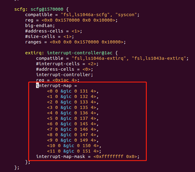

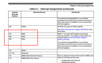

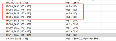

I want to known How to use IRQ0~11 in kernel module independly without "of function"?
and I use follwed code , but all failed。
        irq = 167;
        //irq = 167 - 32;
        //irq = 3;
        //no = irq_create_mapping(NULL, irq);
        irq_set_irq_type(irq , IRQ_TYPE_LEVEL_LOW);
        ret = request_irq(irq, irq_data_handle, IRQF_SHARED, "irqdata", &self);
