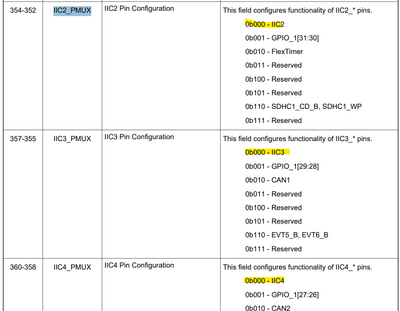

Please also check your RCW, in the last one you shared there is a mistake
The value of those field to use them as IIC is 0b000.

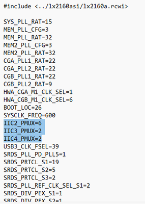

Hello Oswalag,
I have already changed RCW file and now i2c is up. Thank you for youur support. i will attach the updated rcw file content here.

I have created my own custom rcw file. kindly do have a look .

Sorry i shared the wrong rcw file.  am attaching the correct  rcw here
