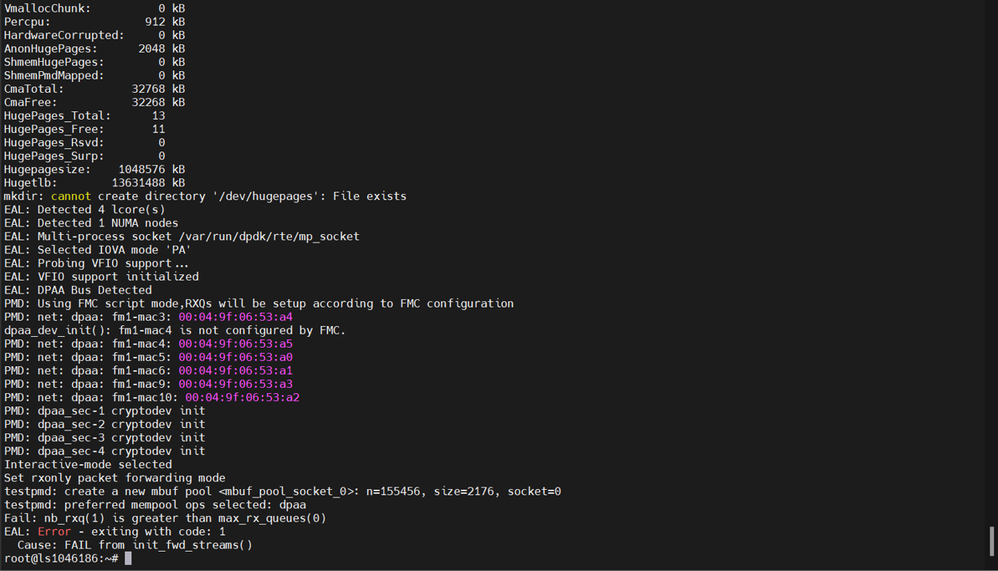

my test command is below.
mkdir /dev/hugepages
mount -t hugetlbfs none /dev/hugepages
export DPAA_NUM_RX_QUEUES=1
fmc -x
fmc -c /usr/local/dpdk/dpaa/usdpaa_config_ls1046_shared_mac10.xml -p /usr/local/dpdk/dpaa/usdpaa_policy_vsp_classif_udp_ipsec_mac10_1queue.xml –a
testpmd -c 0x3 -- -i --forward-mode=rxonly

First, please boot up the target board with /usr/local/dpdk/dpaa/fsl-ls1046a-rdb-usdpaa-shared.dtb
Then configure fmc with
fmc -c /usr/local/dpdk/dpaa/usdpaa_config_ls1046_shared_24g.xml -p /usr/local/dpdk/dpaa/usdpaa_policy_24g_classif_udp_ipsec_1queue.xml -a
