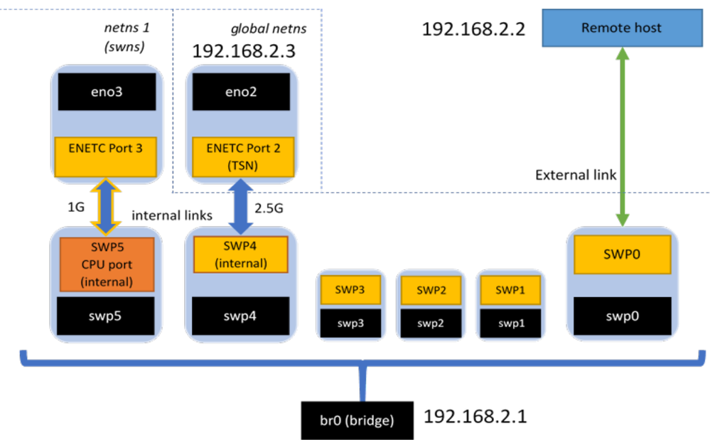

I followed the instructions in LSDK19.09 chapter 8.6.3, but failed to ping 192.168.2.2 remote host from ls1028ardb.

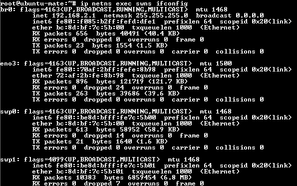

The new namespace and br0's IP address are shown as below. (they should be correct). And I connected remote host (192.168.2.2) to the swp0.
Could you help to check what is the reason behind?
However, I can ping from remote host to ls1028ardb. Is that because gateway configurations are missing on ls1028ardb?

I finally solved it by configuring "swns" configurations and "br0" IP address setting into a batch file, which is executed after reboot the system. And especially, pay attention to "ip netns exec swns ping 192.168.2.2". Also, pay attention to NIC speed which should be 1Gbps.
