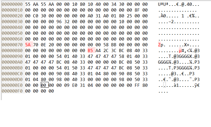

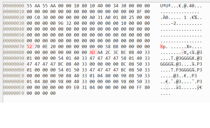

I also tried to boot lsdk21.08 from NOR flash and then imported the original_rcw.bin in the PBL tool and just changed a field for GPIO and tried to write over the modified_rcw.bin in the NOR and boot up again. It does not not work, it does not transmit anything on the serial port.
originial_rcw.bin
modified_rcw.bin
