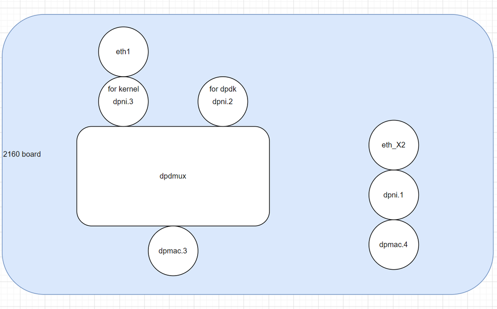

Hi NXP:
       I want to use dpdmux in dpaa2 platform.I refer to section 9.2.12.3 Traffic bifurcation using DPDMUX on DPAA2 of LSDK21.08.According to our own requirements, I made some modifications compared to the example.After successfully creating dpdmux, I found a fatal problem:When I ifconfig up/down the Ethernet interface(eth_X2) on another dpmac(dpmac.4) multiple times, the kernel mem abort.

-sh-5.0# ls-addni --no-link
Created interface: eth0 (object:dpni.3, endpoint: )
-sh-5.0#
-sh-5.0#echo dprc.3 > /sys/bus/fsl-mc/drivers/vfio-fsl-mc/unbind
-sh-5.0#restool dprc disconnect dprc.3 --endpoint=dpni.2
-sh-5.0#restool dpdmux create --default-if=1 --num-ifs=2 --method DPDMUX_METHOD_CUSTOM --manip=DPDMUX_MANIP_NONE --option=DPDMUX_OPT_CLS_MASK_SUPPORT --container=dprc.1
dpdmux.0 is created under dprc.1
-sh-5.0#restool dprc connect dprc.1 --endpoint1=dpdmux.0.0 --endpoint2=dpmac.3
-sh-5.0#restool dprc connect dprc.1 --endpoint1=dpdmux.0.1 --endpoint2=dpni.3
-sh-5.0#restool dprc connect dprc.1 --endpoint1=dpdmux.0.2 --endpoint2=dpni.2
-sh-5.0#restool dprc assign dprc.1 --object=dpdmux.0 --child=dprc.3 --plugged=1
-sh-5.0#echo dprc.3 > /sys/bus/fsl-mc/drivers/vfio-fsl-mc/bind

-sh-5.0# ls-listmac
dprc.1/dpmac.4 (end point: dpni.1)
dprc.1/dpmac.3 (end point: dpdmux.0.0)
-sh-5.0# ls-listni
dprc.1/dpni.3 (interface: eth0, end point: dpdmux.0.1)
dprc.1/dpni.1 (interface: eth_X2, end point: dpmac.4)
dprc.1/dprc.3/dpni.2 (end point: dpdmux.0.2)
dprc.1/dprc.2/dpni.0
-sh-5.0# -sh-5.0#

-sh-5.0# ifconfig eth_X2 down
-sh-5.0# ifconfig eth_X2 up
-sh-5.0# [  693.918781] fsl_dpaa2_eth dpni.1 eth_X2: configuring for inband/sgmii link mode
-sh-5.0#
-sh-5.0# [  694.958374] fsl_dpaa2_eth dpni.1 eth_X2: Link is Up - 100Mbps/Full - flow control rx/tx
[  694.958415] IPv6: ADDRCONF(NETDEV_CHANGE): eth_X2: link becomes ready
[  694.998536] Unable to handle kernel NULL pointer dereference at virtual address 0000000000000048

Please use all the images(such as mc and restool) from LSDK 21.08 release.
Please try whether there is problem to use the default configuration descripted in LSDK 21.08 document on your target board.
