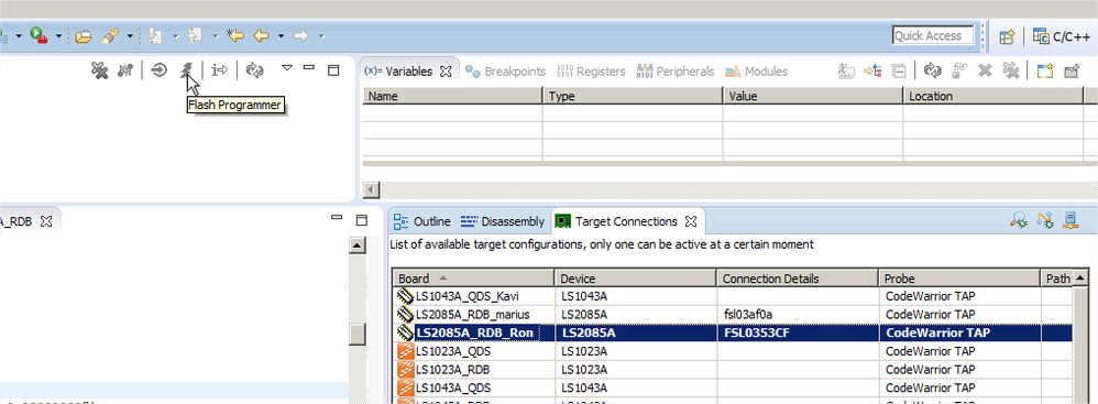

This is normal behavior, because mm command is used only to modify a volatile memory as RAM. For modifying the flash content memory you need to use the cp command.
The same is for using the tools - cannot write/modify the flash content using memory view, but instead you need to use Flash Programmer.
