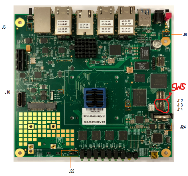

Also since I am working with QorlQ LS1043A board, according to what is said in the document LS1043ARDBGSG QorlQ LS1043A Reference Design Board Getting Started Guide it is possible to disable two cores out of four via switch 5 [3]
in fact when I work with two cores disabled in hardware, U-Boot shows me only the writing CPU0(A53):1600 MHz CPU1(A53):1600 MHz.
I'm sure the cores are disabled, as it's done via hardware somehow.
This switch changes the processor personality between LS1043A and LS1023A.
U-Boot knows these personalities, thus clock frequencies for only two cores are shown for LS1023A.
