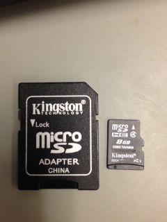

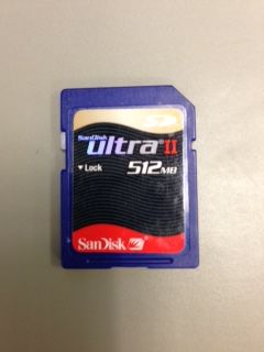

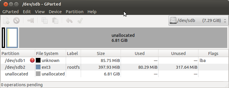

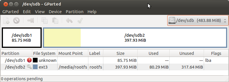

I have a 512MB SD card and a 8GB SDHC MicroSD card.
When booting from 512MB SD card, it is working fine.  But I see a udev timeout when booting from 8GB one.
1) Booting from 512MB SD card

mmc0: new SD card at address a95c
mmcblk0: mmc0:a95c SD512 483 MiB

2) Booting from 8GB SHDC MicroSD
