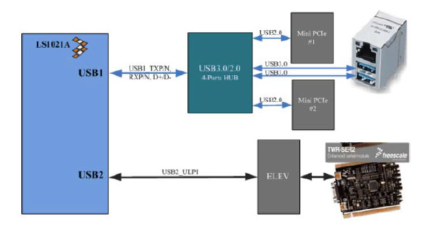

I'm using LS1021A-SDK-V1.3-20141024-yocto with the following change.
diff --git a/arch/arm/boot/dts/ls1021a.dtsi b/arch/arm/boot/dts/ls1021a.dtsi
index 638ac50..0b8cd28 100644
--- a/arch/arm/boot/dts/ls1021a.dtsi
+++ b/arch/arm/boot/dts/ls1021a.dtsi
@@ -764,7 +764,7 @@
                        #address-cells = <1>;
                        #size-cells = <0>;
                        interrupts = <GIC_SPI 171 IRQ_TYPE_LEVEL_HIGH>;
-                       dr_mode = "host";
+                       dr_mode = "peripheral";
                        phy_type = "ulpi";
When loading the UDC Gadget driver, there is a kernel crash so I can't load g_zero.ko.
Can you confirm if USB2 in ULPI is tested for device mode?

yipingwang
Hello Chan Park,
There is only USB3.0 port integrated on LS1021ATWR board, and USB 3.0 is backward compatible with USB 2.0.

TMain
Yiping,
The TWR-LS1021A bd has the USB2.0 port pinned out to the elevator module for connection to the TWR-SER2... This is the port Chan is trying to configure.

cpark
Thanks Todd for the clarification.  That's right.  The USB2_ULPI port is the one that I'm testing.

cpark
I have verified the USB2 UDC in ULPI on TWR-SER2 is working with the following configuration.
1. SDK 1.7
2. RCW EC2=USB2
3. DTS dr_mode = "peripheral"
4. 1K pull-down on CAN3_USB2_SEL
2,769 Views
This is not a correct solution.
Correct is to use the TWR-LS1021A CPLD registers as follows:
1) Set Bit[3] (0x08) in the Register 0x4 to enable CAN3/USB2 Interface Selection
2) Set Bit[0] (0x01) in the Register 0xB to select CAN3
