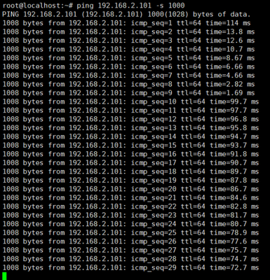

Recently, while testing basetime with the qbv tool on the ls1028 platform, unfortunately, the ports from the vsc8514 switch cannot set the basetime. For example, when setting the current time to 99ms, the actual time decreases sequentially from 99 to 0, cyclically repeating. Below are the steps of my test:
1)qbv config
root@localhost:~# cat > qbv1.txt << EOF
> t0 11111111b 10000
> t1 00000000b 99990000
> EOF
2)Get ptp time
tsntool> ptptool -g
ptp time: 26122.620341052
3)set basetime
tsntool> qbvset --device swp1 --entryfile qbv1.txt --basetime 26123.666
tsntool> quit
 ping 192.168.2.101 -s 1000
PING 192.168.2.3 (192.168.2.3): 1000 data bytes
Please provide the corresponding suggestions.
