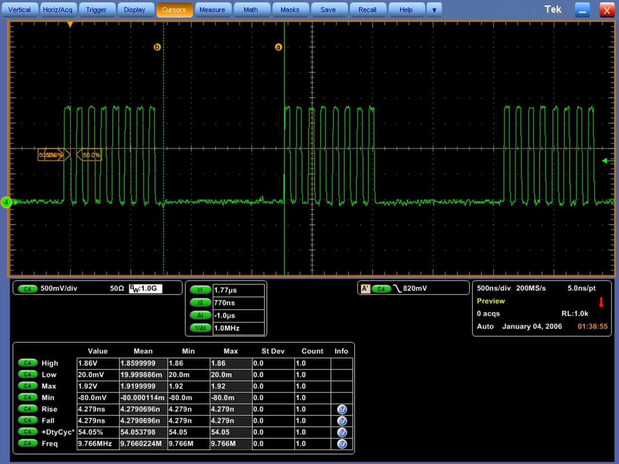

The timing diagram is as follows, and the delay between byte is 1us, see Figure 2 for details.

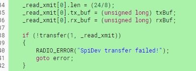

        After viewing the code, it is found that because the buffer sent at one time is 24bit (the chip manual requirements), 24 is a multiple of 8 in the code (not a multiple of 16 and 32), so the code is divided into 3 cycles to send 8bit operations in turn, and the delay is brought by separate transmission.
In this case, is there any way to adjust the latency between bytes?

Dear;
       The SPI interconnects with the Tranceiver ADI adrv902x.  The description of the SPI interface is timely, as shown in the following screenshot. Please check. tINT indicates the delay between Byte and Byte. The maximum value is 400ns. See attachment for SPI description of the device. Thank you!

jack_huang1
Dear
      The spi call procedure is as follows:
        As shown above, the bits_per_word field value in the _read_xmit struct is assigned a default value of 8.
         What other information do you need? Thank you!

Hello @jack_huang1
Hope this post finds you well,
Reviewing your procedure, we notice that you are using SPI dev, which is handled by making transitions defined of 8 bits.
In order to modify this configuration to the 24 bit transitions, you have to modify it on the device tree.
