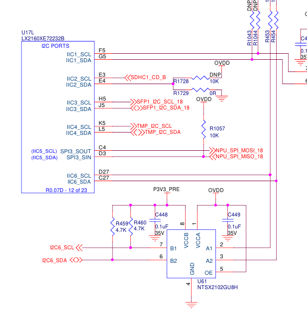

Dear Team,
We are currently facing an issue with the SPI interface. The chip select (CS) line is expected to remain high by default; however, it is observed to be low, and there is some unexpected toggling during the boot process.
For your reference, we have attached the Device Tree Source (DTS) node,, and necessary changes are made in the RCW.
DTS File

Please Note: CLK, MOSI are generated correctly but CS isn't working the same.
SPI3_SOUT i.e. SPI 3 is used in the board.

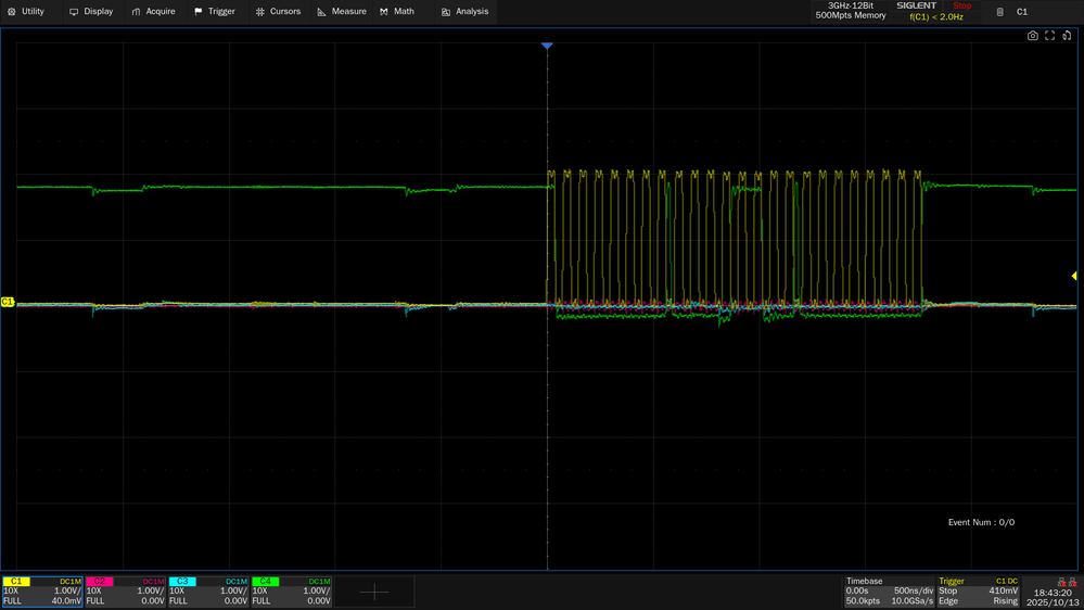

The Yellow is Chip select, Green Data(MOSI), Pink Clock and Blue DIO (MISO)
This is a zoomed out image to show the time gap between Chip select Going low and the Incoming Data
Zoomed in version green as MOSI and yellow as Clock.
why is SPI driver is generating so much delay between CS-CLK.

shivam_kumar
Hey Mr Wang,
We have made the changes and still the SPI behaves the same way
here is a screen shot from PCS1
scale:- 1s/div
this is the full capture from Power on -> Uboot
thank you

shivam_kumar
Heyy yipingwang,
We booted the board via emmc with all the changes and now the CS is working fine. However, CS with SD card BOOT is still not working.
Let us know what you think about it and further steps.
Thank you
