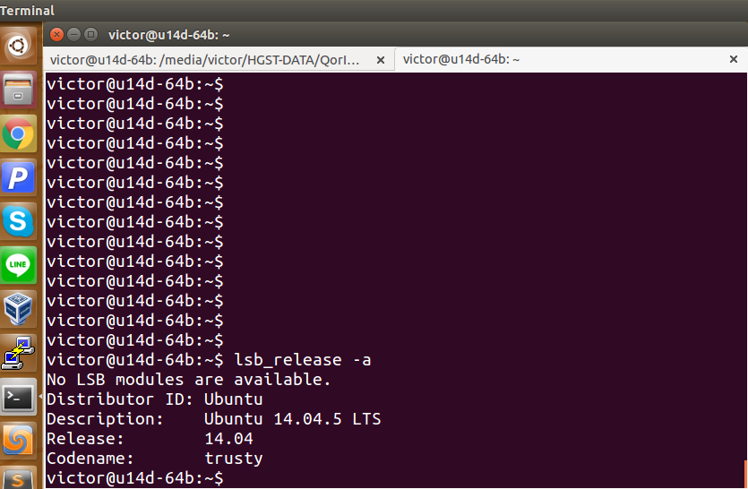

I tried to build SDK2.0, but it has some problems on my computer and the same result on my colleague's computer. Why?
[STEP]
sudo mount -o loop QorIQ Linux SDK v2.0 SOURCE.iso /mnt
/mnt/install
cd QorIQ-SDK-V2.0-20160527-yocto
./sources/meta-freescale/scripts/host-prepare.sh
. ./fsl-setup-env -m ls1043ardb
bitbake fsl-image-full
[LOG]

jheng-jhongwu
Still failed.
But I use a new Ubuntu 14.04 to build SDK, then this problem doesn't show up again.
Thanks for your help.
2,110 Views
anooja_s1
Were you trying to build on NTFS partition when your build failed? What was the file system type when build became successful?
