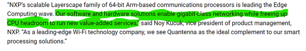

CGganesh
Thanks for your comment,
Can you please provide reply for below further queries,
  1. Does any other NXP SoC with Wi-Fi support have this accelerated Wifi-ethernet support if not LS1043A ?
  2. Secondly, this and similar links seem to indicate that the frames do not need not  go through CPU – since they are referring to Gigiabit throughputs.
https://kommunikasjon.ntb.no/pressemelding/quantenna-partners-with-nxp-on-wi-fi-6-solutions?publishe...
A line therein mentions …
“ Our software and hardware solutions enable gigabit-class networking while freeing up CPU headroom to run new value-added services “\
Could NXP please clarify on this Wi-Fi to ethernet acceleration
By
Ganesh
