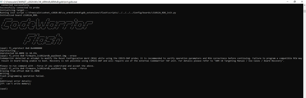

Hi, I was able to connect to the target successfully.
But when I try to write the file. Erase failed with the error seen in the picture attached. Also, I want to know should I change USE_SAFE_RCW = False from False to TrueCapture_gdb.PNG

yipingwang
Please try whether you could write the attached ATF image to QSPI flash of the target board.
fl_unprotect 0x0 0x4000000
fl_write 0x0 bl2_qspi.pbl --erase
fl_write 0x100000 fip_uboot.bin --erase

yipingwang
No need  change USE_SAFE_RCW = False from False to True, you have already configured the switch setting to use hard-coded RCW now.

devchandil
ok, but any solution for the error which I am getting when trying to write the flash. I am getting following error
Flash programming operation failed.
Additional error details:
[FP: can't write memory]
8,214 Views
