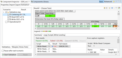

muaxi8
Contributor V
Platform: LX2160A customized board card。and my ddr4 is discrete type.
I did the validation with QCVS, then what should I do to use the calibrated value.

yipingwang
Please refer to section "1.1.1.2 Configure DDR controller" in the attached QCVS DDRv user guide.
After creating a QCVS DDR project for Discreate DRAM with the default parameters, please fill "Properties" panel according to your DDR Datasheet.

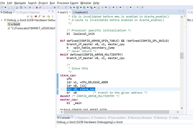

muaxi8
Contributor V
hi yipingwnag:
how to use codewarrior to debug uboot ? my pbl It's already ok, but my uboot can  not start up.

muaxi8
Contributor V
hello.
when i debugging uboot with codeworrior, my uboot  is wrong here: cbz x0, slave_cpu.
What does the mean of "slave_cpu",  What cause the wrong here?
thanks.

muaxi8
Contributor V
3,879 Views
yipingwang
This should be the code for the slave core, entering into sleep mode. Please attach to the master core to check the problem code.
