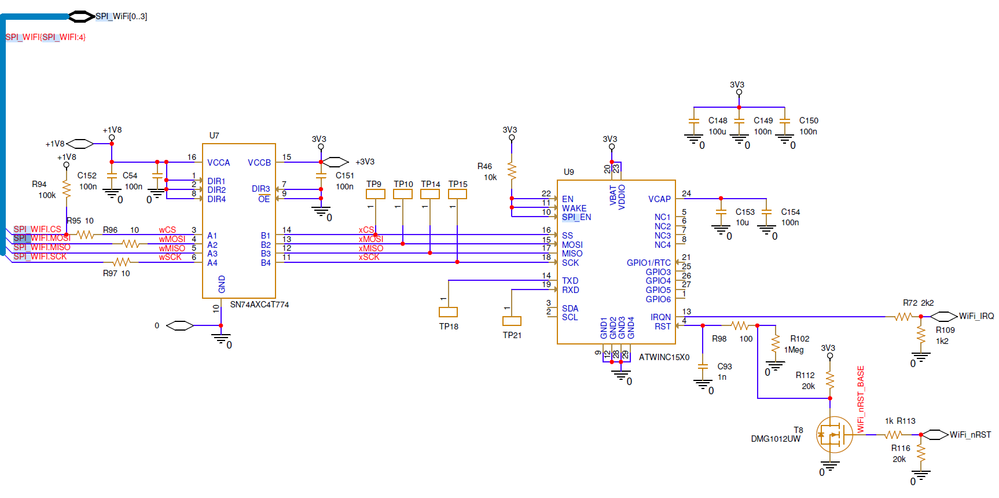

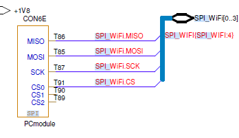

Please advise me on the device tree for carrier board with LS1028a and WiFi module ATWINC1500, which is fixed on the board and should communicate via SPI. The wiring diagram is below (not my work).
My problem is that I don't know how to build a device tree, all the information I found was about implementations on Atmel SoC.

On boot, the driver module is loaded into the kernel. When starting wpa_supplicant or ifconfig wlan0 up, the firmware is loaded, but after about 10 seconds it ends with a Time out error.
Could someone please advise me where I am going wrong ? Or if anyone has a device tree for the same or at least similar QoorQ or Layerscape and WINC1000/WILC1500 ?

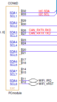

The situation has changed a bit, I'm sending updated info about WiFi module wiring and modified device tree. Currently the driver crashes on firmware startup (timeout). I believe I have a bug in the device tree (irq), possibly in RCW:
Here is the connection update on the board:
WIFI_IRQ - now connected at pin B17 (SDA6)
WIFI_nRST - now connected at pin B18 (SCL6)
&dspi2 {
