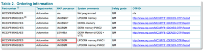

Can I use MC33PF8100EPES PF8100 as PMIC for LS1046a hardware design? Please find datasheet attached
Thanks in advance.

11,911件の閲覧回数
Ellu24
I have one more question that is it acceptable to use MC33PF8100EPES for LS1046 as this PMIC is programmable?
Thanks in advance
Elizabeth
11,905件の閲覧回数
diazmarin09
Hello Elizabeth,
I hope all is great with you.
As mentioned before, you can use the SW4 regulator for example. In this case, please be aware about the current. The SW4 can supply up to 2.5A.
I am afraid that the PMIC is not capable of providing 20A.
Finally, please note that the MC33PF8100EPES device is designed to be compatible with the i.MX8QM.
I recommend to review the EP configuration to determine if the device is useful for your application.
I hope this information helps.
David

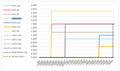

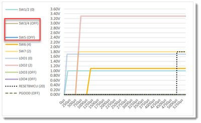

Ellu24
Hi ,
Thank you very much for your prompt replies. When I checked EP configuration, I found that switch 3,4,5 are off.So is it possible for me to program those regulator with my desired voltage and current and use it for LS 1046.
Please see this and express your opinion regarding this.
Thanks in advance
Elizabeth
11,882件の閲覧回数
diazmarin09
Hello Elizabeth,
Thank you for using the NXP communities.
You are correct, based on the EP configuration , the following regulators are OFF by default.
After the start up, you can configure such regulators based on the requirements of your design.
I just want to make sure that you are not using the EA configuration as it was designed to work with the LS1046A processor.
David
