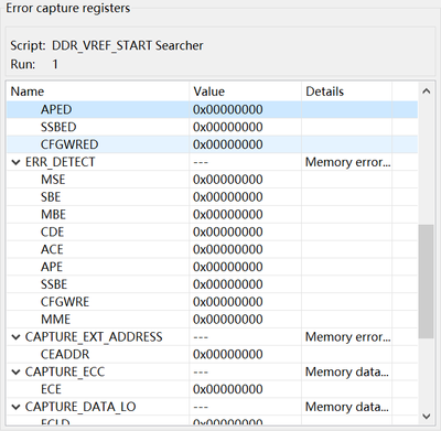

10,946 Views
muaxi8
Contributor V
 this is the  Error capture registers values...there valuse are all 0x0

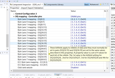

muaxi8
Contributor V
Does the DQ mapping need to be configured? my dram type is discrete...

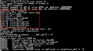

After compiling with the flex-builder -c atf -m lx2160ardb_rev2 -b xspi command, bl2_flexspi_nor.pbl and fip_uboot.bin,programmed it to the  Flash, but it still prompts the 2D Training .(I turned on the Debug switch).Debugging several days, all the time not to the main point
 The following is the log information, looking forward to your reply...

2D Training failure
ERROR:   Execution FW failed (err -5)
Program controller registers
twopass=0
PHY handshake timeout..., ddr_dsr2 = 0
total size 4 GB
Need to wait up to 1320 ms
ERROR:   Found training error(s): 0x100
ERROR:   Error: Waiting for D_INIT timeout.
ERROR:   Writing DDR register(s) failed
ERROR:   Programing DDRC error
ERROR:   DDR init failed.
NOTICE:  Incorrect DRAM0 size is defined in platform_def.h -5
