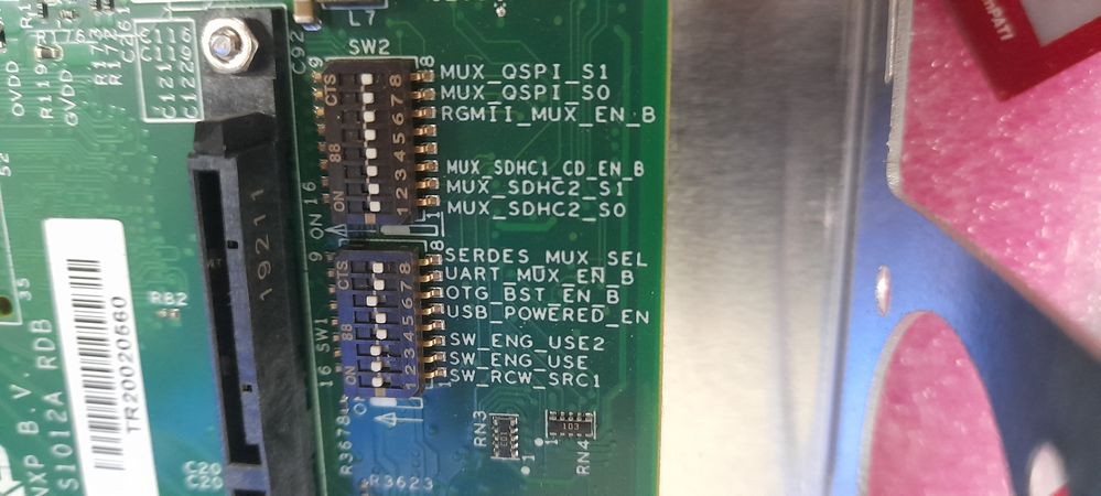

Switch settings of the board
switchswitch

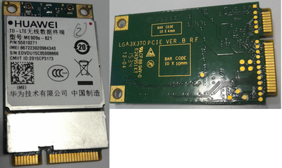

  1. There are two variants in modem Huawei ME909s-821. Which one is used by customer?
    (Huawei ME909s-821 Variants -- a) Huawei ME909s-821 LGA Form Factor  b) Huawei ME909s-821 Mini PCIe Form Factor)

1. here is my modem, I guess it is mini pcie form factor
