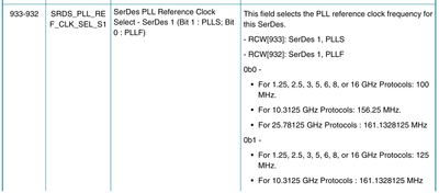

tsungmin_wang
We have checked that our fiber module can make the port link up on RDB board.
I'm not sure is the ref clock the problem.
Our PLLF is 156.25 MHz and PLLS is 100 MHz.
And default are both 161.13 MHz.
So, I wonder how to change this setting.
I think I should set SRDS_PLL_REF_CLK_SEL_S1=0, is it right?
I have tested this setting, but it doesn't work. Should I set something else?
