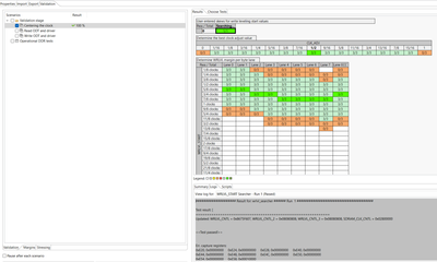

Currently, we're facing issues validating DDR memory with CodeWarrior: the DDR initialization fails during the first test ("Auto search & detect for write leveling start values") in the QCVS tool under the "Centering the clock" scenario.
The logs show the same output for `wrlvl_searcher` that is seen in the post:
DDR read/write issues custom board LS1046A

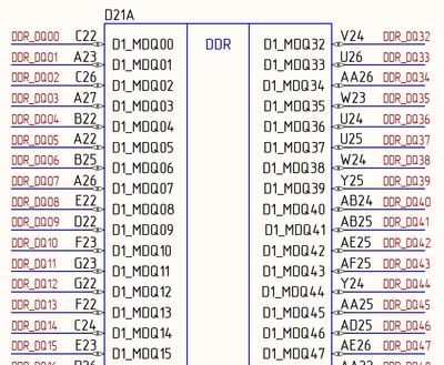

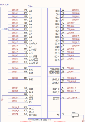

Attached are screenshots from our board schematic:
- D16A shows one of the SDRAM chips.
- D21A shows a fragment of the DDR controller in the LS1046A.
Please focus on pins DQ0–DQ15 and associated DDR_DQxx nets.
Based on "Table 15-6. Bitfield settings for each byte lane" in the LS1046A Reference Manual, our current assumption for correct mapping is:
DQ[0:3] = [3,0,2,1] (0x14)
DQ[4:7] = [7,4,6,5] (0x34)
DQ[8:11] = [3,0,2,1] (0x14)
DQ[12:15] = [7,4,6,5] (0x34)
Is this mapping correct, or should it instead look like this?
DQ[0:3] = [1,3,2,0] (0x0C)
DQ[4:7] = [5,7,6,4] (0x2C)
DQ[8:11] = [1,3,2,0] (0x0C)
DQ[12:15] = [5,7,6,4] (0x2C)
Any advice or confirmation would be greatly appreciated.

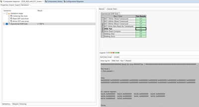

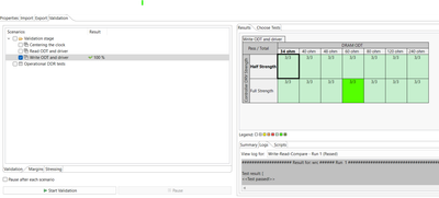

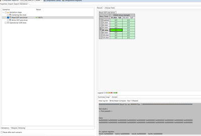

UPDATE: we finally sorted it out, and we've got all DDR tests passed in CodeWarrior recently for our LS1046A custom board with 4GB + ECC memory (see screenshots).
Correct mapping is in the second listing. 
Mapping happens from the DDR controller point of view.
I provide correct mappings as example for the attached earlier screenshot to help new people who will be break their brains on this question:
LS1046        SDRAM
DDR_DQ00  ->  DQ1
DDR_DQ01  ->  DQ3
DDR_DQ02  ->  DQ2
DDR_DQ03  ->  DQ0
i.e. [1,3,2,0] 0x0C
LS1046        SDRAM
DDR_DQ04  ->  DQ5
DDR_DQ05  ->  DQ7
DDR_DQ06  ->  DQ6
DDR_DQ07  ->  DQ4
i.e. [5,7,6,4] 0x2C
LS1046        SDRAM
DDR_DQ08  ->  DQ9  (1)
DDR_DQ09  ->  DQ11 (3)
DDR_DQ10  ->  DQ10 (2)
DDR_DQ11  ->  DQ08 (0)
i.e. [1,3,2,0] 0x0C
LS1046        SDRAM
DDR_DQ12  ->  DQ13 (5)
DDR_DQ13  ->  DQ15 (7)
DDR_DQ14  ->  DQ14 (6)
DDR_DQ15  ->  DQ12 (4)
i.e. [5,7,6,4] 0x2C
Regarding to the question about mappings in LS1046AFRWY:
it turned out that [0,1,2,3] is eqiuivalent to [4,5,6,7].
