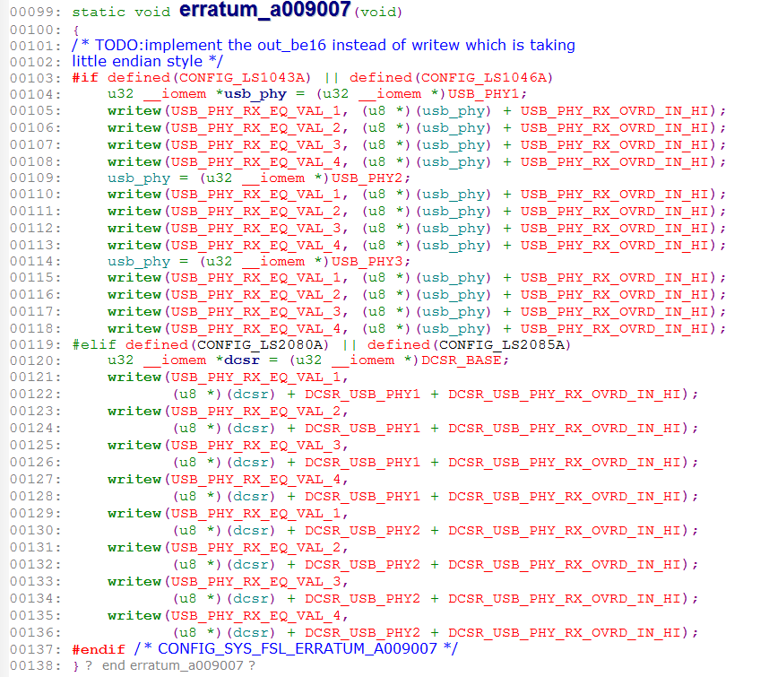

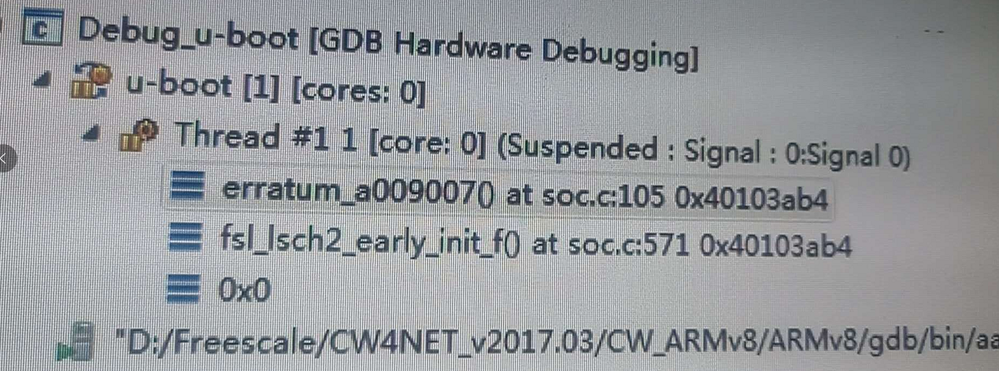

I debugged the UBOOT with the codewarriar, and It halted at the "erratum_a009007(); at soc.c 105"
I have tried some times and It always halt at that function.

And the Debug info is:
What should I do next?

We also had this issue with our custom LS1046A board. We faced out that the problem was related to the clocking of the USB blocks.
The CKSEL field of the USB PHYx Reference Clock Select Registers (SCFG_USB_REFCLK_SELCRx) defaults to 10 (reference clock of USB PHY PLL comes from DIFF_SYSCLK/DIFF_SYSCLK_B). On our board the single ended SYSCLK is used so the USB PHYs are not supplied with a valid clock input. After changing CKSEL to 00 by the following PBI commands fixed the boot problem:
#USB PHY frequency sel
09570418 0000009c
0957041c 0000009c
09570420 0000009c

And my SDK version is 1703. I saw the uboot src code.
