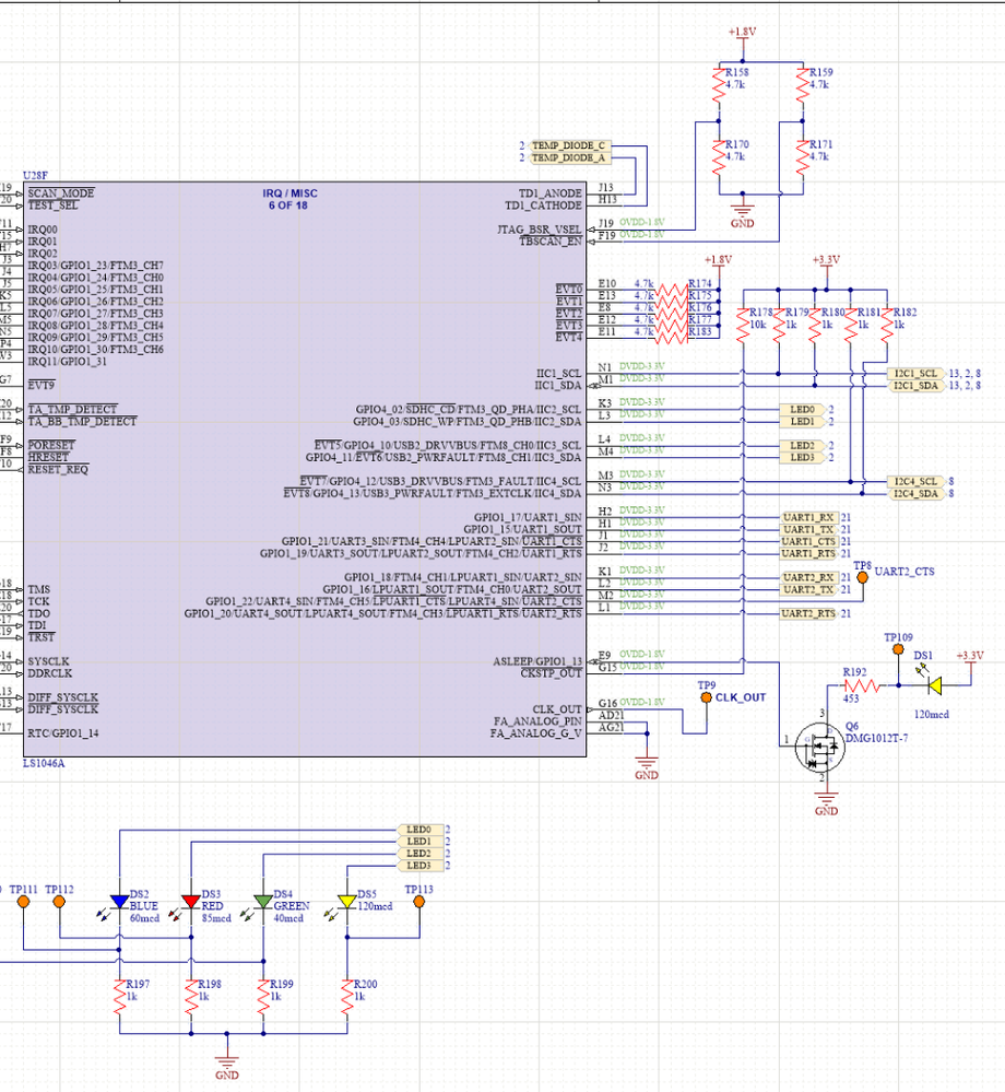

Hello. We have an LS1046A based board. We are during the bring up process
and are validating the GPIO lines we need. We faced unexpected behavior
on one of the lines.
One of the GPIO (GPIO4[2]) cannot be set to OUT HIGHT despite writing to the
DIR / DATA registers.
This is the U-Boot code we use for this test:
/* GPIO4[2,3,10,11] */
val4 = (1 << 29) | (1 << 28) | (1 << 21) | (1 << 20);
read4 = in_be32(&pgpio4->gpdir);
printf("gpio4->gpdir before: 0x%x\n", read4);
setbits_be32(&pgpio4->gpdir, val4);
printf("gpio4->gpdir after: 0x%x\n\n", read4);
read4 = in_be32(&pgpio4->gpdat);
printf("gpio4->gpdat before: 0x%x\n", read4);
setbits_be32(&pgpio4->gpdat, val4);
printf("gpio4->gpdat after: 0x%x\n\n\n", read4);
This is U-Boot output:
gpio4->gpdir before: 0x0
gpio4->gpdir after: 0x30300000
gpio4->gpdat before: 0x0
gpio4->gpdat after: 0x10300000
As you can see, the GPDAT bit for GPIO4[2] is not being set.
I believe the pinmux for those pins is correctly set within the RCW. Both GPIO4[2,3]
are muxed to GPIO by the same single bit RCW[I2C_EXT] = 010.
So if the setting was incorrect, I would expect both GPIO4[2,3] to not operate.
We had similar issue for the GPIO2[26,27] and it turned out that we cannot have
them muxed to GPIO while having the QSPI_A_DAT3 enabled at the same time.
I could not find a similar issue for the GPIO4[2] in the reference manual.
Escpecially that muxing it is tied with the GPIO4[3], which works correctly.
Are there any other mechanism that would prevent this GPIO from operating? Thanks.

macpijan
We figured out that we can control this GPIO line when the SD card is NOT inserted in the SD slot.
This GPIO can be muxed to SDHC_CD via [IIC2_EXT], but it is NOT.
The CD signal from the SD card connector is NOT connected in any way to the SoC.
The behavior is the same both in U-Boot and when controlling the GPIOs via PBL commands
(no external software is running on the CPU, only the PreBootloader).
The GPIO4[2] is connected only to the LED, as shown on the schematic below.

ufedor
GPIO4_2 multiplexing is performed only during POR according to the RCW data.
Please use a digital scope and check external level of the K3 pin when the SD card is inserted/removed.
1,543 Views
macpijan
SD card inserted:
- K3 is LOW (no matter whether we are driving this pin od not)
SD card not inserted:
- K3 is HIGH when we set it to HIGH
- K3 is LOW when we set it to LOW or do not configure it as GPIO
