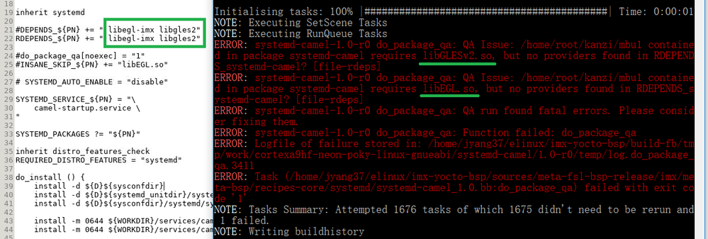

csoapy
I'm facing the same issue, in official bsp imx-4.14.98-2.1.0
