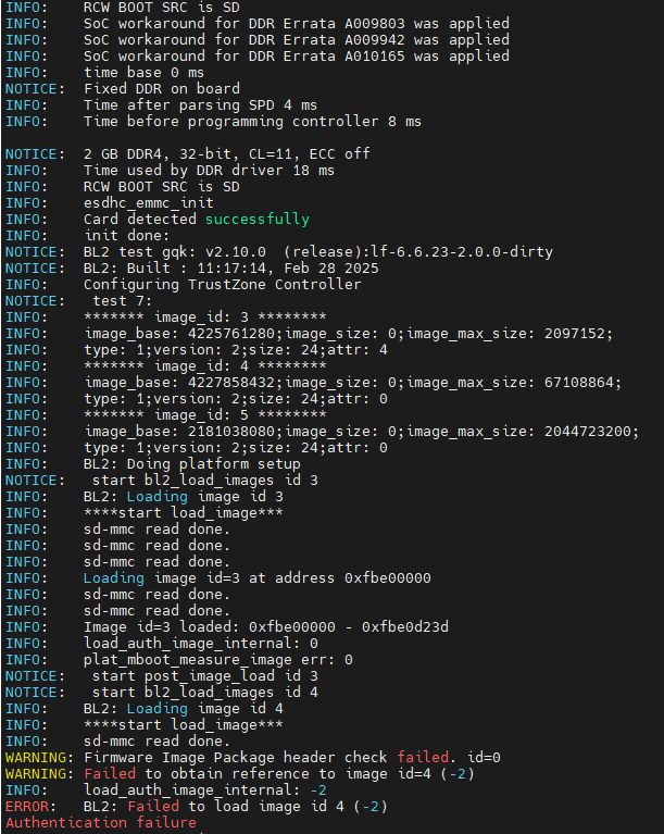

Hello, When burning the system via an SD card on my 1028A board, I encountered issues during the BL2 phase of TFA (Trusted Firmware-A). Sometimes it fails at loading image 4 during the BL2 stage, and other times it fails at loading image 5. The specific issues are as follows. How can I resolve this problem? thank you!

NOTICE: BL2: Built : 11:17:14, Feb 28 2025
INFO: Configuring TrustZone Controller
INFO: ******* image_id: 3 ********
INFO: image_base: 4225761280;image_size: 0;image_max_size: 2097152;
INFO: type: 1;version: 2;size: 24;attr: 4
INFO: ******* image_id: 4 ********
INFO: image_base: 4227858432;image_size: 0;image_max_size: 67108864;
INFO: type: 1;version: 2;size: 24;attr: 0
INFO: ******* image_id: 5 ********
INFO: image_base: 2181038080;image_size: 0;image_max_size: 2044723200;
INFO: BL2: Doing platform setup
NOTICE: start bl2_load_images id 3
INFO: BL2: Loading image id 3
INFO: Loading image id=3 at address 0xfbe00000
INFO: Image id=3 loaded: 0xfbe00000 - 0xfbe0d23d
INFO: load_auth_image_internal: 0
NOTICE: start post_image_load id 3
NOTICE: start bl2_load_images id 4
INFO: BL2: Loading image id 4
WARNING: Firmware Image Package header check failed. id=0
WARNING: Failed to obtain reference to image id=4 (-2)
INFO: load_auth_image_internal: -2
ERROR: BL2: Failed to load image id 4 (-2)
Authentication failure

1. Please use QCVS DDRv tool to do DDR optimization and validation.
2. Please refer to the following document to debug ATF.
https://community.nxp.com/t5/Layerscape-Knowledge-Base/Debugging-ATF-and-u-boot-with-CodeWarrior-for...
