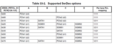

Please refer to the following SerDes configuration on LS1021A platform. In your RCW configuration, you configured RCW[128:135] as 0x70, so SGMII1 on your platform is disabled.
